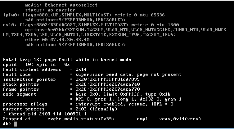

Do you have more than one NIC in your FreeNAS server? Unless they are deliberately bridged, each needs setting up separately. The first NIC available on installation is, I think, automatically set to DHCP unless you choose a static IP. Additional NICs are not enabled at all, I think, though this is an n=1 observation. Unless you set up DHCP on the T520 in the GUI (or CLI for that matter) it will not be enabled at all. Though that shouldn't cause a crash, setting it up as fixed *or* explicitly DHCP would at least provide different conditions for the driver. I'd try both if you haven't already. Doing so shouldn't affect your other NIC(s).
Have multiple NICs. Tried both static and DHCP address. Both crashes. It seems like driver loads cxl0, but crashes when trying to activate cxl1 (if that's possible) ? See attached images...
See https://dl.dropboxusercontent.com/u/14441857/chelsio_1.jpg and https://dl.dropboxusercontent.com/u/14441857/chelsio_2.jpg
BTW I had to pull out the card to boot FreeNAS, if it's inserted it crashes.

Quick update. Got the same card back from Chelsio with a mention that it's working... strange, so I have to try it in another server.

Hi Lars,
Have you had the chance of trying this in another server? Plus have you tried it with the 9.3.1 branch? :smile:

Haven't tried another server, but did try 9.3.1 with the same result not working, see screenshot :-/
