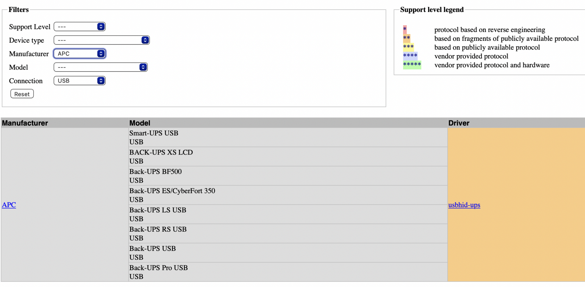

TrueNAS and ReadyNAS both use NUT
Pick one of the models that will use the usbhid-ups driver.
You will need to set up TrueNAS as a UPS Master and the ReadyNAS as UPS Slave, or since you have ReadyNAS UPS working, set up ReadyNAS as Master and TrueNAS as Slave.

Perfect. Thank you for your insight Elvisimprsntr. Seems I have a selection box of drivers to work with there. Much obliged!
