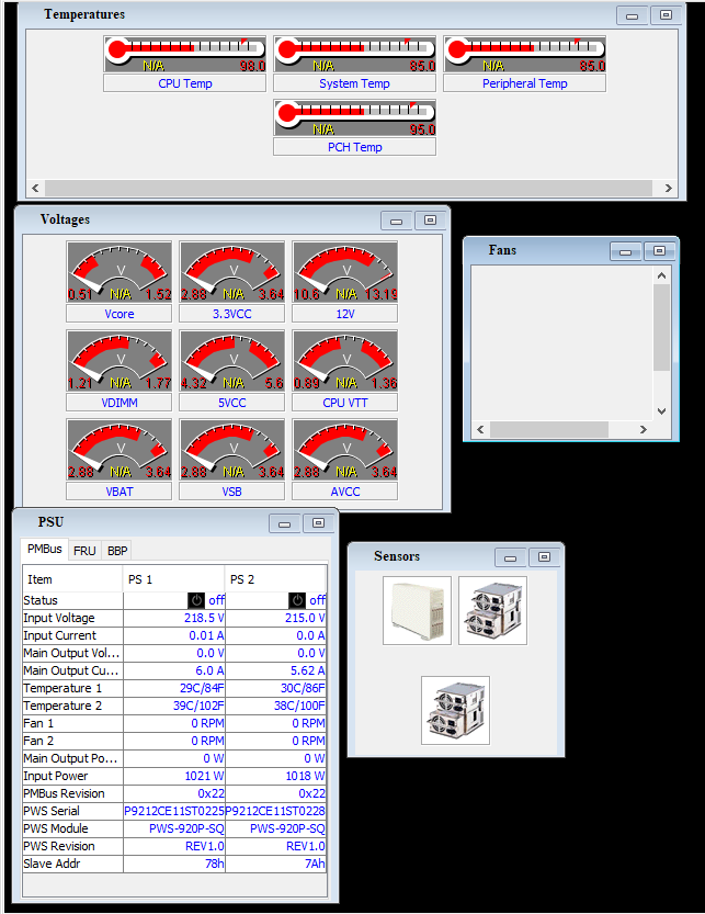

So, that did not work...
This is what IPMI View shows me:
Any other suggestions?

AND then... after not working for 3 hours, it just suddenly appaired. Why, and how... I have no idea.
