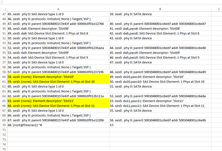

Out of curiosity, what is the output of dmesg | grep ses0

Here is the output from mine:
[root@plexnas] ~# dmesg |grep ses0
ses0 at mpr0 bus 0 scbus0 target 20 lun 0
ses0: <LSI SAS3x28 0601> Fixed Enclosure Services SCSI-5 device
ses0: Serial Number
ses0: 1200.000MB/s transfers
ses0: Command Queueing enabled
ses0: SCSI-3 ENC Device
ses0: da0,pass0: Element descriptor: 'Slot00'
ses0: da0,pass0: SAS Device Slot Element: 1 Phys at Slot 0
ses0:  phy 0: SATA device
ses0:  phy 0: parent 5003048001cc6ebf addr 5003048001cc6e80
ses0: da1,pass1: Element descriptor: 'Slot01'
ses0: da1,pass1: SAS Device Slot Element: 1 Phys at Slot 1
ses0:  phy 0: parent 5003048001cc6ebf addr 5003048001cc6e81
ses0: da2,pass2: Element descriptor: 'Slot02'
ses0: da2,pass2: SAS Device Slot Element: 1 Phys at Slot 2
ses0:  phy 0: parent 5003048001cc6ebf addr 5003048001cc6e82
ses0: da3,pass3: Element descriptor: 'Slot03'
ses0: da3,pass3: SAS Device Slot Element: 1 Phys at Slot 3
ses0:  phy 0: parent 5003048001cc6ebf addr 5003048001cc6e83
ses0: da4,pass4: Element descriptor: 'Slot04'
ses0: da4,pass4: SAS Device Slot Element: 1 Phys at Slot 4
ses0:  phy 0: parent 5003048001cc6ebf addr 5003048001cc6e84
ses0: da5,pass5: Element descriptor: 'Slot05'
ses0: da5,pass5: SAS Device Slot Element: 1 Phys at Slot 5
ses0:  phy 0: parent 5003048001cc6ebf addr 5003048001cc6e85
ses0: da6,pass6: Element descriptor: 'Slot06'
ses0: da6,pass6: SAS Device Slot Element: 1 Phys at Slot 6
ses0:  phy 0: parent 5003048001cc6ebf addr 5003048001cc6e86
ses0: da7,pass7: Element descriptor: 'Slot07'
ses0: da7,pass7: SAS Device Slot Element: 1 Phys at Slot 7
ses0:  phy 0: parent 5003048001cc6ebf addr 5003048001cc6e87
ses0: da8,pass8: Element descriptor: 'Slot08'
ses0: da8,pass8: SAS Device Slot Element: 1 Phys at Slot 8
ses0:  phy 0: parent 5003048001cc6ebf addr 5003048001cc6e88
ses0: da9,pass9: Element descriptor: 'Slot09'
ses0: da9,pass9: SAS Device Slot Element: 1 Phys at Slot 9
ses0:  phy 0: parent 5003048001cc6ebf addr 5003048001cc6e89
ses0: da10,pass10: Element descriptor: 'Slot10'
ses0: da10,pass10: SAS Device Slot Element: 1 Phys at Slot 10
ses0:  phy 0: parent 5003048001cc6ebf addr 5003048001cc6e8a
ses0: da11,pass11: Element descriptor: 'Slot11'
ses0: da11,pass11: SAS Device Slot Element: 1 Phys at Slot 11
ses0:  phy 0: parent 5003048001cc6ebf addr 5003048001cc6e8b
From what I can see, it all looks good!
depasseg
FreeNAS Replicant
Sep 16, 2014
2,874
It does. In fact yours looks better than mine. My da10 and da11 devices aren't named and yours are. hmmmmm
