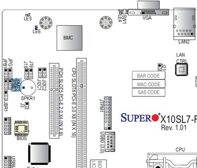

Hello krikboh. I just wanted to add that I was suffering from a similar problem since I got my X10SL7-F a few days ago ... up until just an hour ago.
I've updated my BIOS and IPMI firmware and everything is working well except I've once again lost the temperature reading for my CPU. It shows NA in my IPMI console, but all other temperatures read fine. I tried flashing the BIOS with the JPME1 and JPME2 jumpers set to 2-3, but no difference.
Since I received my board I couldn't get temperatures for the CPU or PCH. I'd tried updating the bios, IMPI firmware and using ipmicfg.exe -fd, but none of it worked. So I contacted Supermicro support, and the guy helping me had me try a few things.
First was to flash a as-yet-unreleased IPMI Firmware of version 1.45. That partially helped, in that I finally got the missing temperatures on the first update, but on all subsequent updates they reverted to N/A.
The latest advice was to reflash the same (latest) bios, but to do with with jumper JPME2 in the "ME" setting. After that another new advice was to remove the CMOS battery for a few minutes (instead of shorting the "clear CMOS" terminals, as I'd previously done).
At first this appeared not to have worked. In fact, all the temperatures were showing N/A now. So I decided to give it a final ipmicfg.exe -fd for luck [drum roll] and suddenly all the values came in, updates and all.
So I don't know what the initial problem was, and I don't know which steps actually fixed it, but I do know I can no-longer detect any problems. Bit of a shame the heartache was needed in the first place, but I was quite impressed by the speed of the Supermicro support guy. Didn't seem like the usual "Have you plugged in the monitor, sir?" I've experienced from some other companies.

Right... be aware that all values are NA until syustem is powered on and finished posting.
This is what i got from Supermicro on the matter:
It is possible something is wrong with the ME firmware on the board.
You can try reflashing the board with the JPME1 and 2 jumpers set to 2-3 (see below). After flashing set the jumpers back.
