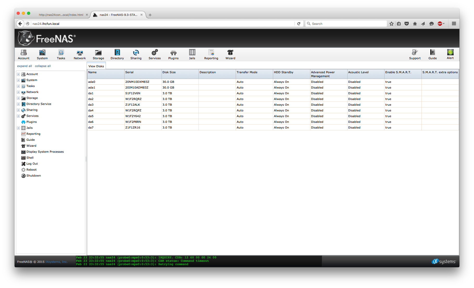

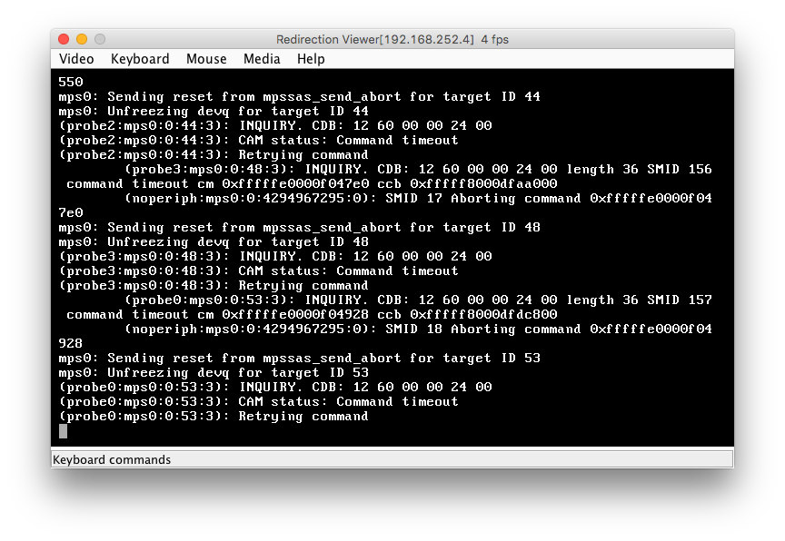

So a quick update, with a couple screenshots attached. While I was writing this post, machine #2 which I thought was hung finally booted. There are loads of messages on the console about disk errors and the GUI only sees 7 of the 24 drives in the system. See attach pics and remember, if I put the Adaptec card back in it comes up right away and sees all 24 drives.
