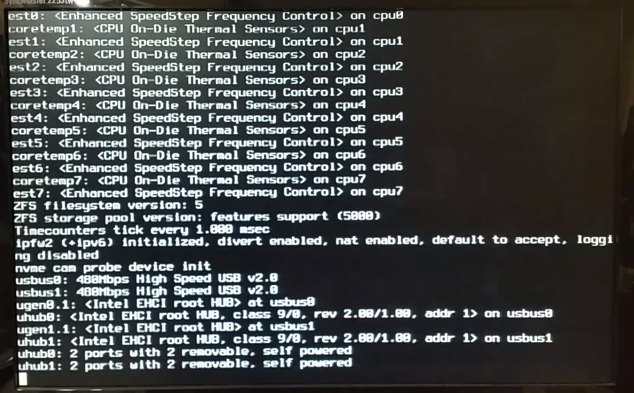

Image of last screen before it shuts down, this was a video so quality might not be clear as the screen was scrolling quite fast.

Is there a way to log the boot sequence to a file to see where it crashed, to view the last events of the crash?
A serial console, basically. Not sure if your server can do Serial over LAN, but that would be the way.
