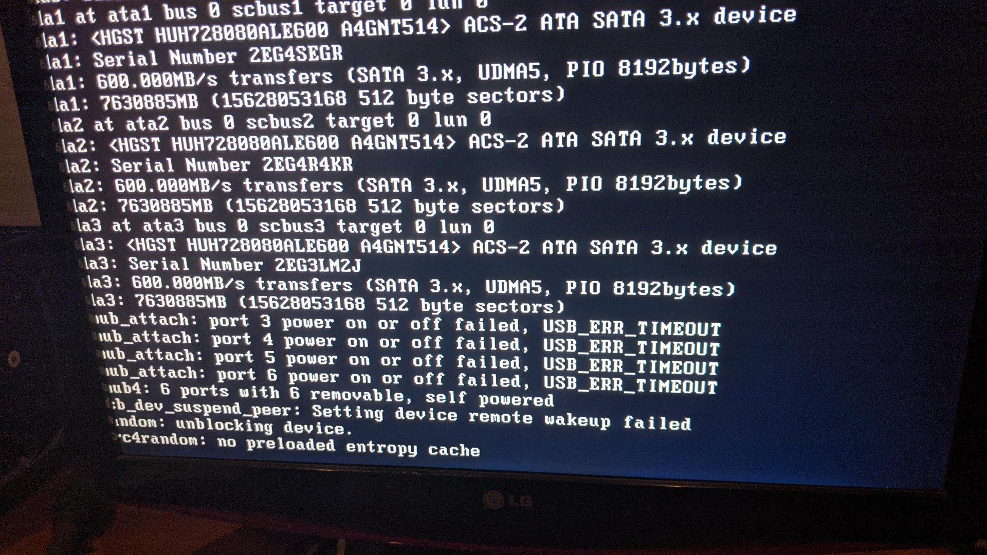

I can’t connect any drives internally and reboot, it just hangs. If I try to reinstall with the drives connected it also hangs with this error
sb_dev_suspend_peer: Setting device remote wakeup failed

Thanks for your reply. The initial problem was Rufus and USB related, which is now sorted, I read (and tried) as much as I could, i think it was using Balena Etcher and the legacy settings that fixed it in the end. The next issue was with the disk management, it just refused to boot after install (Sata is set to IDE btw.) I have since had some success in that I managed to install all of the drives by connecting them and formatting in TrueNAS after the boot. I then did a fresh install which succeeded. However it takes an age to boot - (about an hour). Works ok when finally running. I think in hindsight this could have been the problem earlier I didn't realise- just a really, really long boot up. Not sure how to copy the logs but I took a pic where it hangs on boot, in case there's something I can try to speed it up. Cheers!

An hour to boot is extreme. My boot time would be 5-10 mins at best on an older config than your own. I do feel your RAM is on the low side but not sure this might contribute. With TrueNAS, more RAM is better. Have you tried to install TrueNAS from one USB on another USB stick (for trial purposes ofcourse) instead of the mSATA SSD just to see if there is any difference in behavior?
Another thing to check are any power saving settings in the BIOS related to the HDD's.
