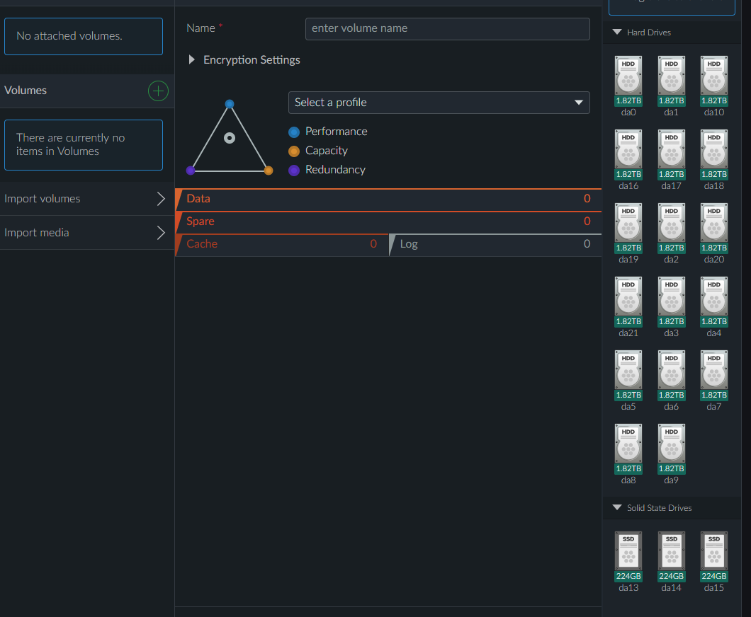

Hello Community.
Our company bought new server Supermicro with two enclosures (1 and 2). We are using controller LSI 9300 (firmare SAS9300_4i4e_IT)
we have 6 HDD and 6 SSD in enclosure 1 and 12 HDD in enclosure 2.
The problem is - FreeNAS can't see disks from BAY 0 from both enclosures. We can use only 5 SSD and 17 HDD. This is really annoying. If we change SSD from bay0 to HDD then we have 6 SSD and 16 HDD, still only 22 storage devices.
We can't see bay0 disks from freenas 10.0 and 11.0 installer, and after installation too.
geom disk list shows only 22 storage devices.
Dunno how to fix that, any suggestions?

As i noted before, if i run installer FreeNAS 11.0-U4 i see only 22 disks in installer. It doesn't make sense to install it. We got absolutly same situation.
We are already using version 10 Corral on our old server, it is stable and doesn't have any problems for 4 months.

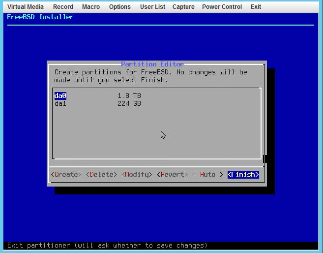

Ok, new info:
1. I removed all disks except bay-0
2. I tried to install FreeBSD 11. Installer can see both disks.
3. Standalone FreeBSD works fine with all 24 disks.
How can i make bug report?

At the top of the Forums page is a link called "Report a Bug". I'm glad you isolated the problem to the software.
