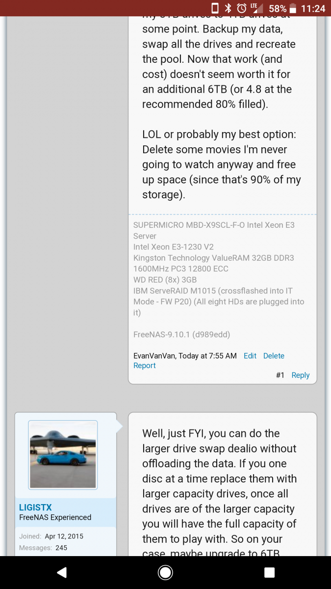

And signature's work fine on Chrome mobile...
It's dependent on screen width. Most phones in landscape do not show signatures at typical zoom levels.

15,504
...but not in Tapatalk, which is what most mobile users use.
