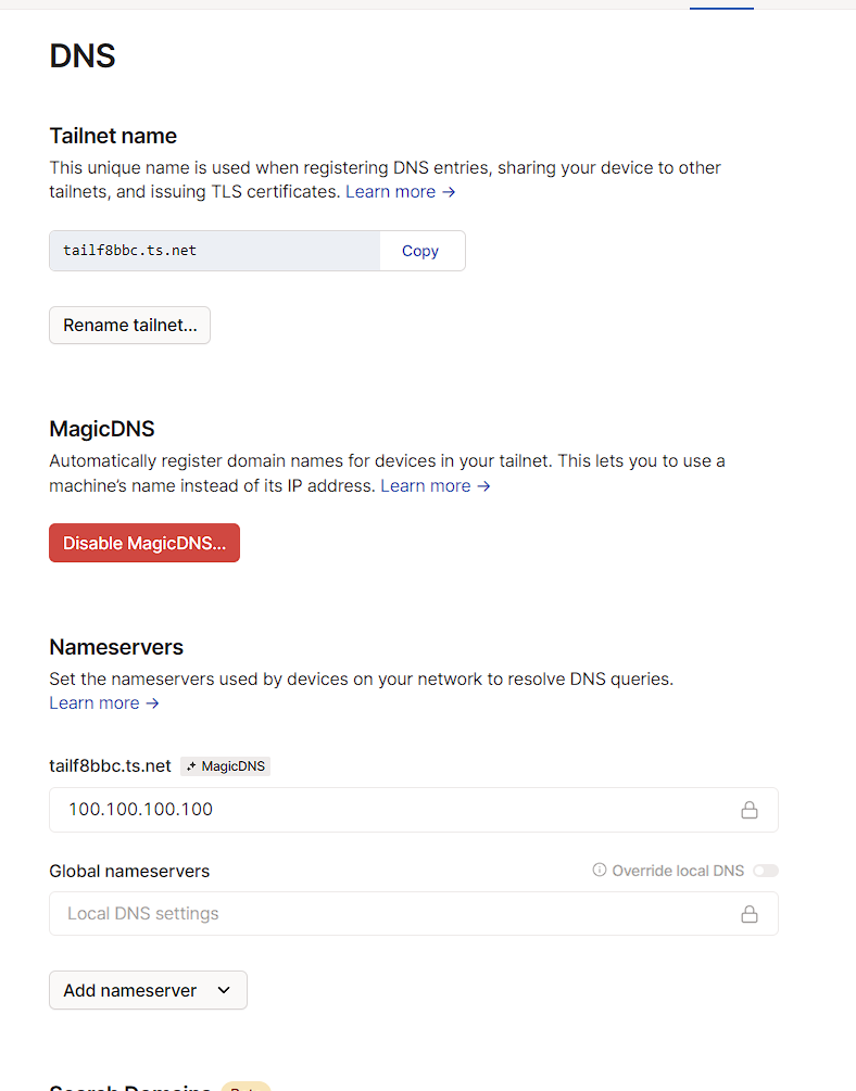

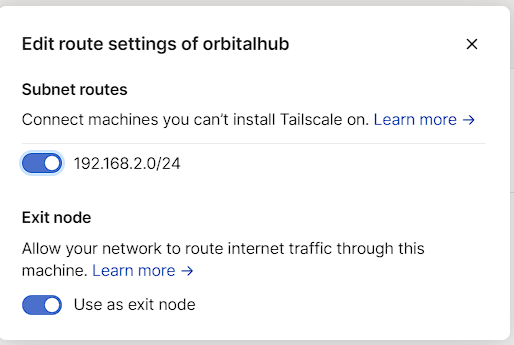

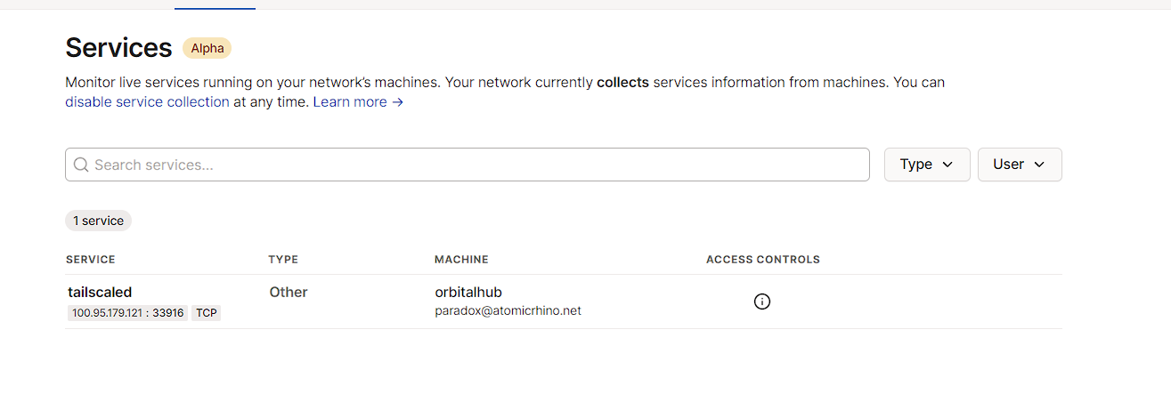

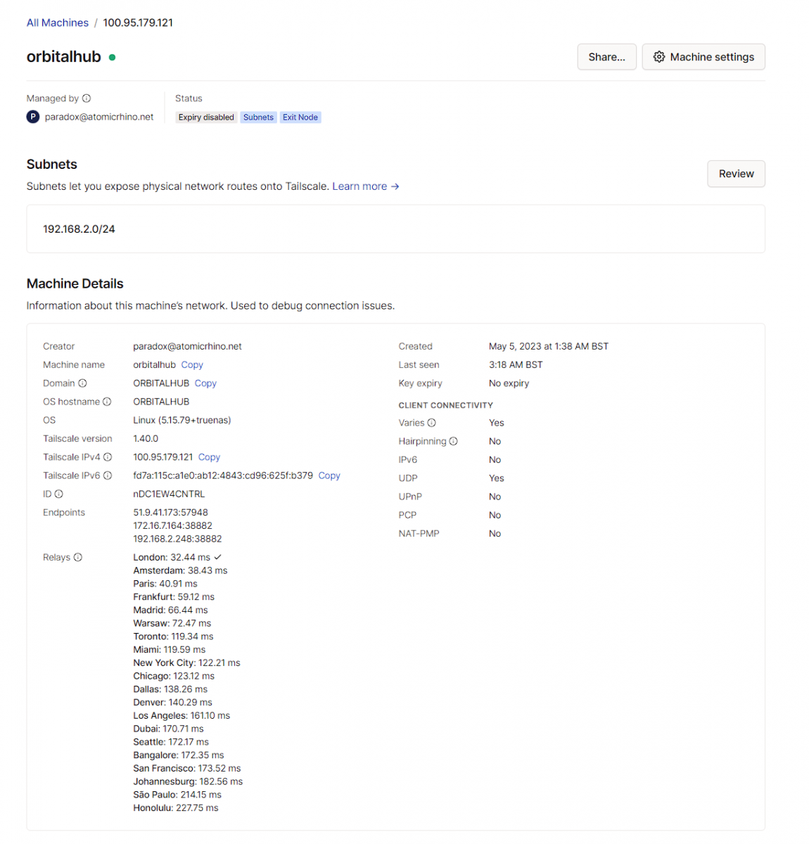

This is the tailscale website:
That is from running the tailscale truecharts docker app.

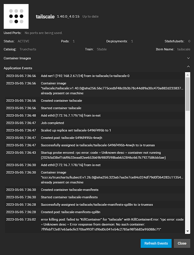

Album showing the ts docker apps settings: https://imgur.com/a/0VFUiX7

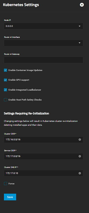

Kubernites settings:

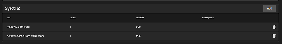

Sysctl settings:

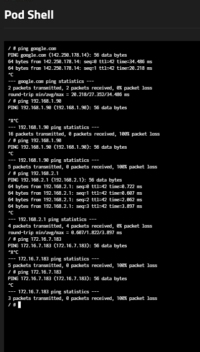

Pinging from inside the tailscale shell:
The last one is the IP for overseer app kubernites gave it.

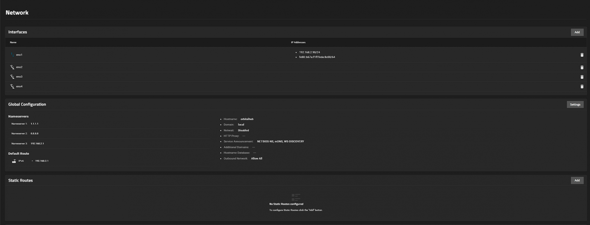

More network config settings:
Hopefully this is enough info someone can help.
