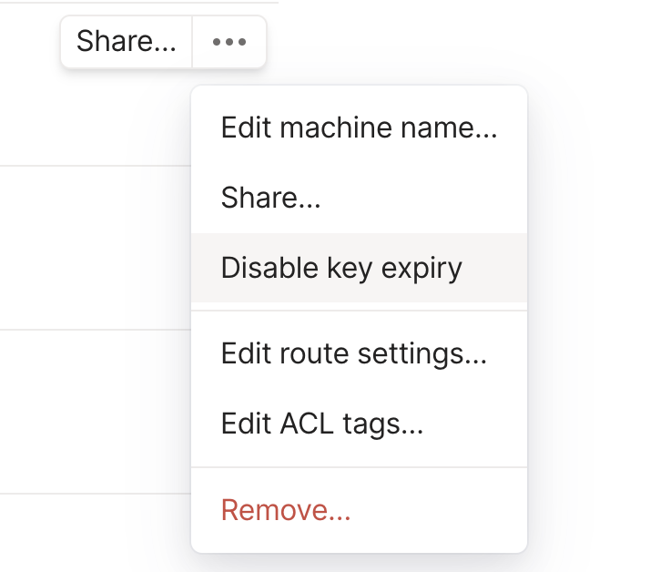

even a reusable key expires after 90 days so this is not "set and forget".
Not if you tell it not to...
Although a reusable key isn't actually the one referred to here, it's the initial connection key.
Once a machine is connected to taiolscale, it has its own key that's only known to itself and the tailscale system. It's that key you can set not to expire, hence not needing another one to be generated from the reusable key.
