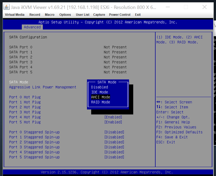

I tried disabling the Intel RAID but I am certain that I used the wrong BIOS option. When it boots it still shows me the Intel RAID screen for half a second.
In the BIOS I diabled the Option Advanced -> SATA -> SATA RAID Option ROM/UEFI Driver. Where is the right option?
Booting with the drives installed still didnt work.
So I got a Molex to SATA Adapter today and tried that (like shown in the video). I really thought that this would work because the Adapter only has 4 power cables instead of 5 which my old power cable had. But still it only display A2 POST Message.
Edit: Setting SATA Mode to IDE gives A3 (IDE Enable) so its one step further.
Chris Moore
May 2, 2015
10,079
Gaspetaahl
