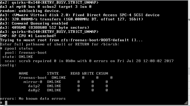

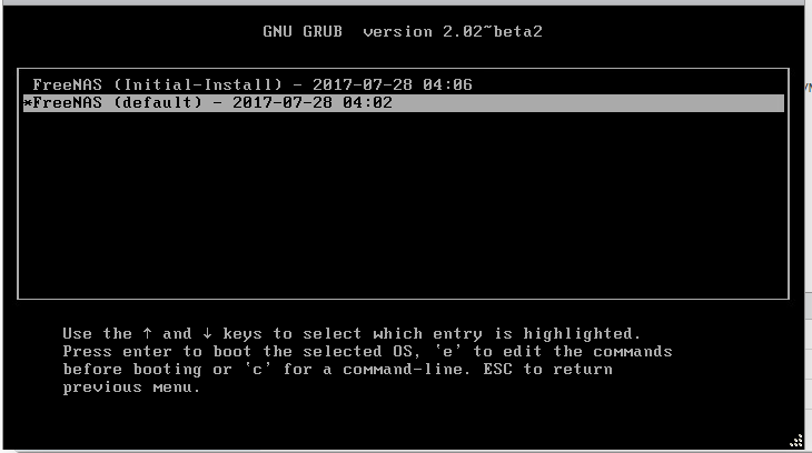

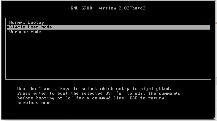

I just tested it... if you choose a boot environment at startup, then you can choose single-user mode, and if you do do that, then it doesn't auto-mount the pools (other than boot pool).
Thought so

EDIT: No, the GUI is not operational (had to try it myself). I'm not sure how useful going into Single User Mode would be for this situation. There are a lot of programs not running at this point and FreeNAS is basically just dropped to a command prompt. I can see this being okay to correct a corrupt configuration but not sure how you can tell the system not to import the pools and then finish loading up FreeNAS. I'm sure it could be done though with some extra work.
EDIT2: WOW! Verbose Mode is well... Verbose! Hey, I gave it a try and was hopeing it might just give an option to accept each command or ignore it. No such luck. Maybe we need a "Troubleshooting Mode".
