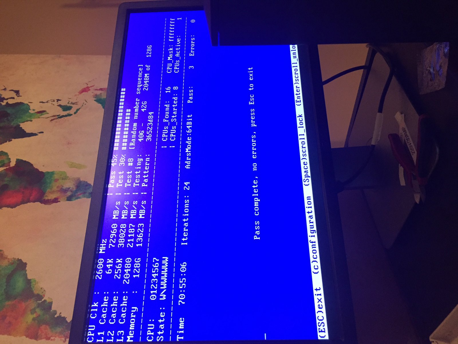

wreedps
Jul 22, 2015
225
Long enough????
jgreco
Resident Grinch
May 29, 2011
18,680
Long enough????
Seventy hours and three passes? Not really, at least not here. Part of the burn in process is to see what problems appear, so running memtest for a *month* is quite reasonable. Happy to see that you had all CPU's active though.
