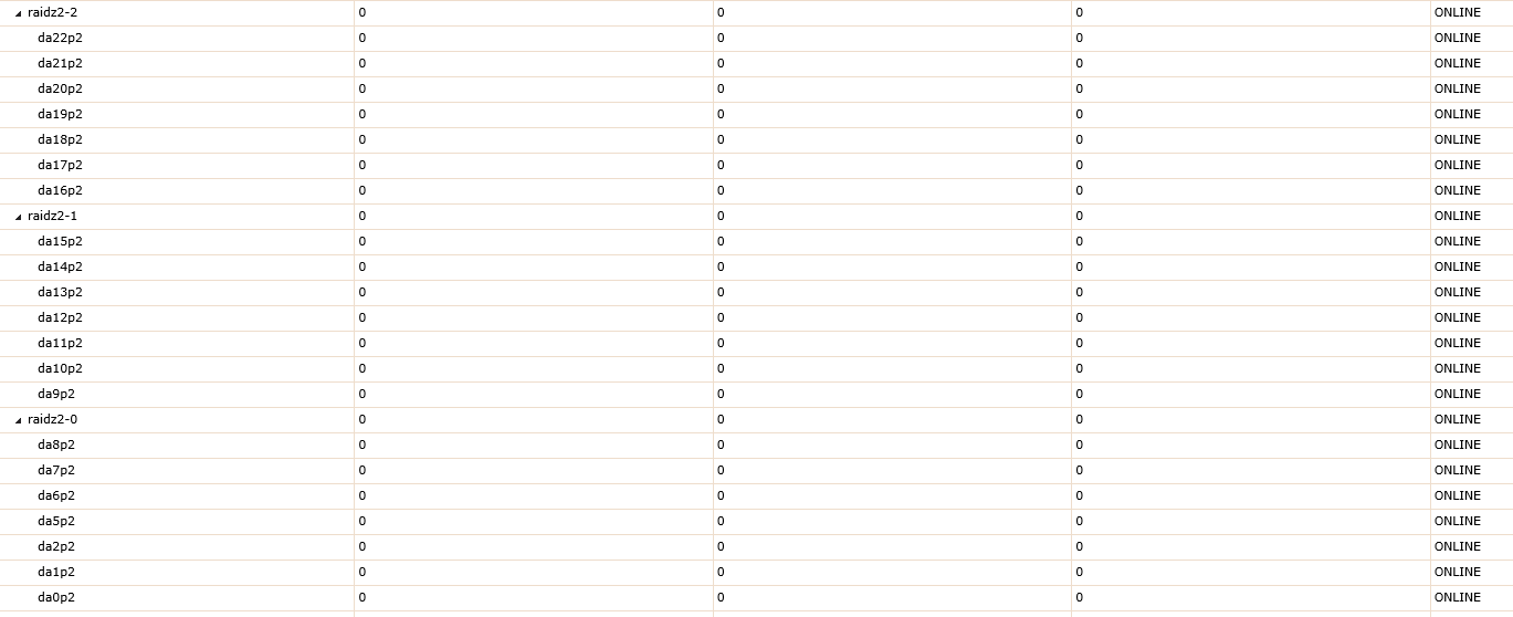

If I'm reading that correct you have a 23 wide Z2 pool? Recommended Z2 width is no wider than 8-10.
ESXi VM access is recommended mirrors, so 11 x Mirrors with extra disk left over.

I attached a copy of the storage configuration, I used the Wizard when I created it so my apologies for not fully understanding it in its completeness.
Regarding the pool storage, I had read that 80% was the 'do not cross' line for performance, but other sources have shown write deteriorates at 15% full to 50% speed. Can't find the link that I read that from in my history which doesn't really help. But regardless, the pool is at 41.9% presently.
10GBe definitely in the future, but in the mean time, its not a bottleneck presently. When I use a file that's been loaded into the ARC, I can saturate all 4 1GBE NICs (4GBPs), but read performance isn't a problem, just write.
With the attached screen-shot, am I in violation of the width you are referring to? Ultimately, it sounds like instead of having 3 mirrors, for my Z2 Pool, more mirrors = more IOPs.
