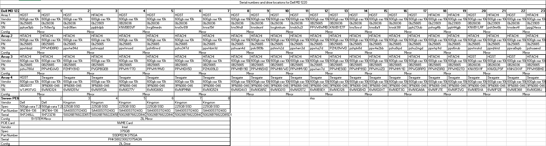

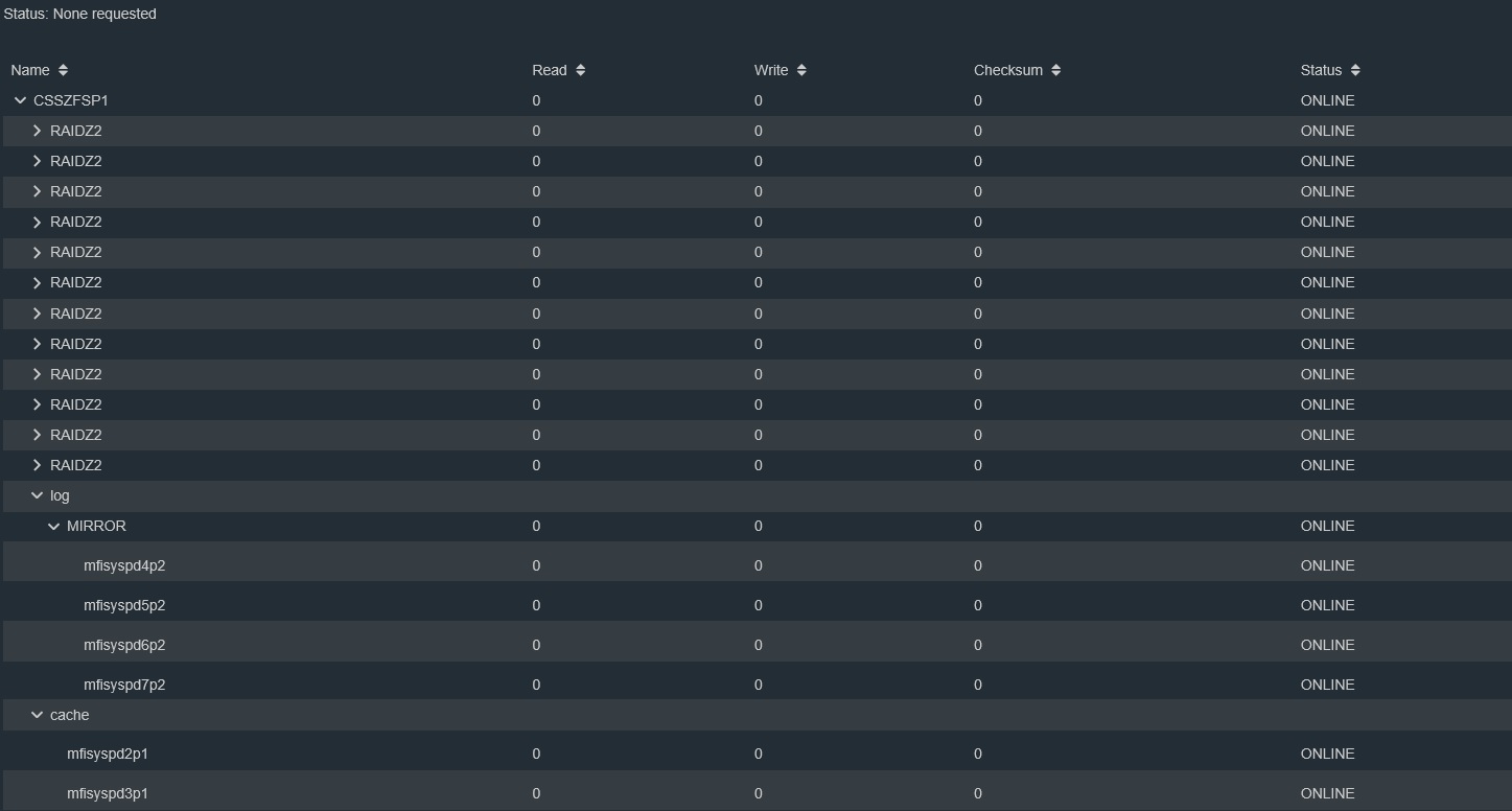

Hi All
I'm a network manager that is ore accustom to working within a windows environment. We have a requirement to increase our storage provision, however additional nimble boxes are prohibitively expensive. I have been looking at other options that could operate in a windows environment running Hyper-V failover cluster. Our existing storage does not have the capacity or throughput to the network to cope with current demand.
I was looking to repurpose a Dell PowerEdge R620 that was previously used as a virtual host - its specs are 384GB Ram and duel Xeon e52620. The server has 4 x 10 GBE NICS and a HBA. in addition, i am debating repurposing 3 dell PowerVault MD1220 disk shelves with 24 x 600gb 10k SAS drives.
I’ve installed Freenas on the server and configured 2 on-board SATA drives in a mirror for the system. In addition to that i have created a pool consisting of 12 x z2 vdevs consisting of 6 x 600gb SAS drives and added 2 x 250gb ssd for L2ARC and 4 x250gb ssd as a mirror for the LOG. the network cards are configured for MPIO and the server is setup for iSCSI.
I have one windows server connected via iSCSI and all appears to work "okay ish" until we start to move data around. After 100gb or so, the copying halts and the server hangs. It eventually recovers but i cannot fathom out as to why this keeps happening.
Any help or advice would most welcom....

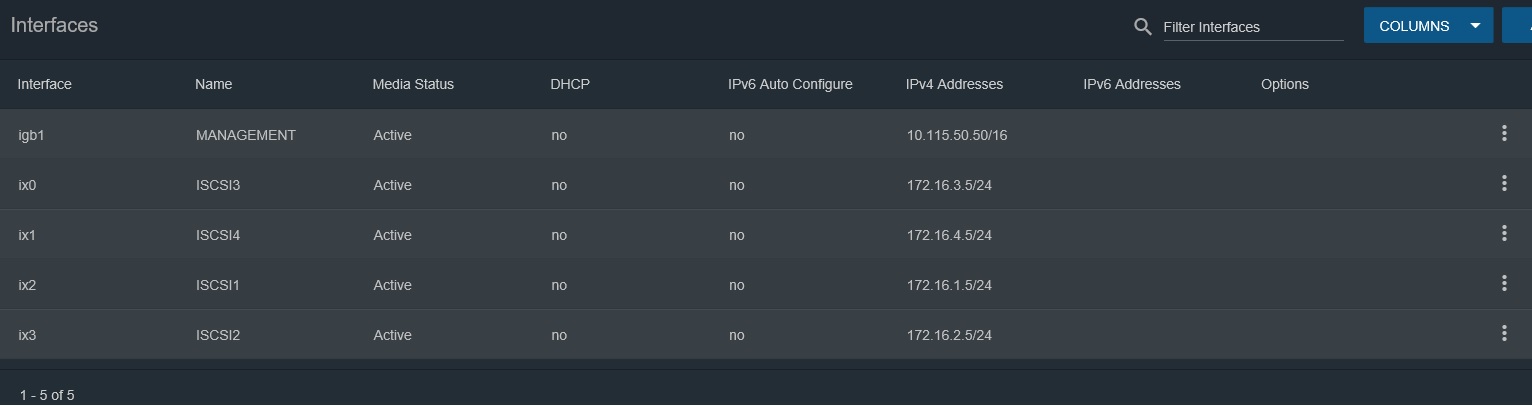

We'll want to take a look at the network topology as well. Depending on the answer to the HBA question, you may need to use a regular PCIe slot in your system to connect to the internal drives.
Regarding your potential causes of slow performance:
The drives are being obfuscated by a RAID card, and you're eventually blowing out its write cache. This won't help.
Your SLOG devices aren't likely being used at the moment (iSCSI default sync is "don't bother")
RAIDZ2 is not an optimal configuration for virtual machine hosting - strongly prefer mirrors for random access. I know this costs you space, but the performance advantage is significant.

Hey, thanks for the reply.
The HBA in use is a dell 12DNW, this is a PCIe card. The r620 is making use of an internal perc h310 in none raid mode. This is driving the system drive and 6 x 250gb SSDs.
The SSDs are some consumer Kingston drives that we had lying around - that said I will happily replace them with something more suitable if the setup can be make to work well and reliably.
I’m happy with any and all suggestions that will improve proformance as this does promis to be a rather cost effective solution.

Assuming we find a solution to the PCIe slot problem, my suggested layout is quite simply "36 vdevs of 2-way mirrors" - that will give you maximum random performance. Attach the NVMe SLOG, set sync=always on the volumes, and because the default volblocksize for iSCSI is 16K, everything should flow merrily through the attached log device.

As it stands the system has 1 full hight slot with the HBA inserted and a 1/2 hight with an intel x520 da2 NIC inserted.
We could remove the intel nic in favour of an
Intel P3700 reducing or network ports to 2. Their appears to be a number of Intel P3700 options in relation to capacity; would capacity matter?
Thanks for your help and support with this, it is very much appreaciated.

I would suggest removing the x520 and sticking with the onboard 10GbE ports is the way to go; in a sync write setting you're far more likely to be bound by your SLOG performance.

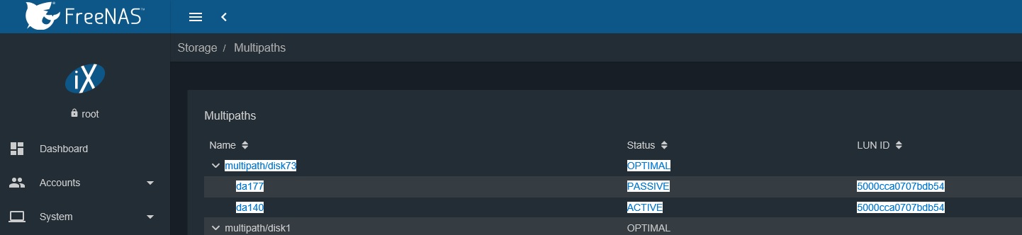

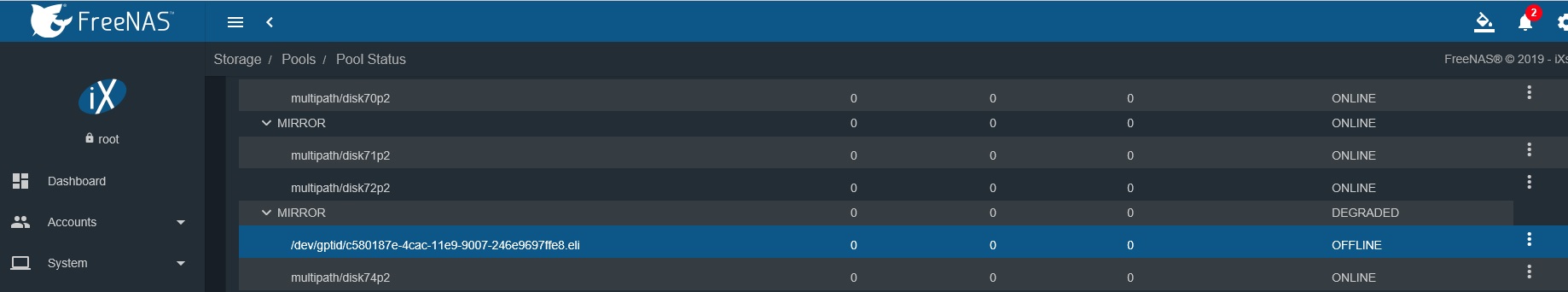

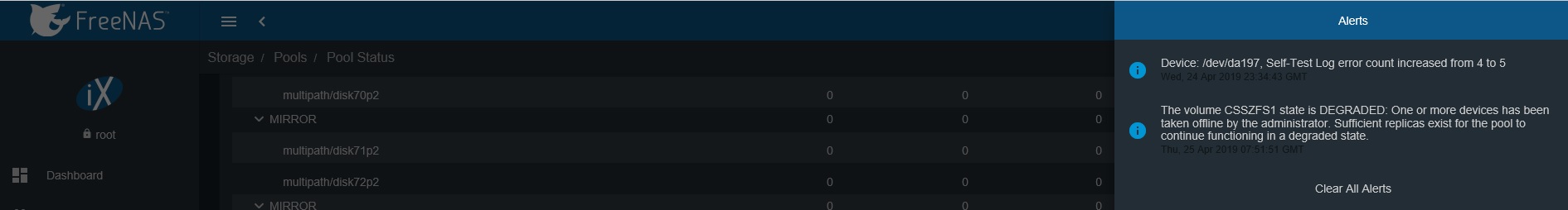

Over the weekend we had two drives report a "self-test long error count" increase (see alerts error.jpg for an example). I ordered some replacement drives that came yesterday and in line with information i could find online, went to “Disks” to check the serial number of the failing drive (so i could compare it to a spreadsheet detailing its location). I then went to multipath to document the disk and paths prior to going to “pool status” to take the drive offline (in this instance DA177). The replacement drive was inserted into the same drive bay as the faulting drive. I checked on “disks” to see what “Name” was associated to the new drive serial number (it was again DA177) and returned to “Pool status” and selected the “replace” option for the offline drive. In the replacing disk dialogue, I select the member disk DA177 and click replace but get the error “Select a valid choice. Da177 is not one of the available choices” (see replacing disk error.jpg)
Am I doing something wrong or missing a step or two?
