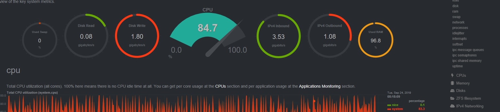

I’ve attached a print screen of netdata; its a typical view when i have a few classes saving video projects to the windows file servers hosted on freenas.
Our network:
Each distribution switch is connected to the core with 2 x 10Gbps LAG. The core switch is made up of 3 x 48 port HP 5900 in an IRF with 4x 40Gbps connections between each). In turn our virtual servers have 4 x 10 Gbps connections to each side of the core. The iSCSI side of things is based on 2 x HP 5920AF in an IRF, all virtual hosts have 4 x 10Gbps connections to this in an MPIO arrangement.
I get the throughput to this appliance is limited because of the number of 10 Gbps connections to it (2 at the moment in an MPIO config) but when writes get close to the network limit the CPU usage is close to 100%

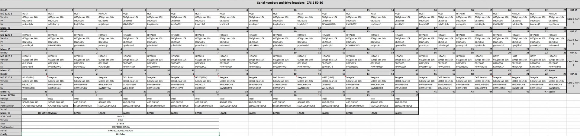

The Pool is encrypted and setup with 47 mirrored drives all 600GB SAS @ 10k (see attached ZFS2.jpg for more info). in addition it has 14 Intel SSD for l2ARC and an Intel Optain PCIE NVME drive for ZIL.

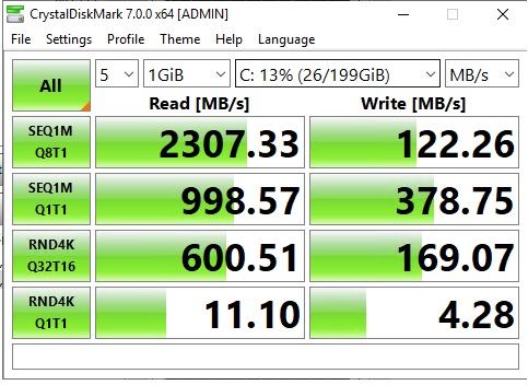

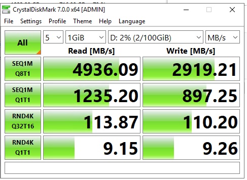

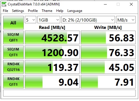

physical test.jpg shows results from crystaldiskmark from a physical computer connected to freenas with sync set to standard. Physical test sync always.jpg shows the same computer doing the same test but with sync set to always. The final tests was run from a VM that was running on the computer the other two tests came from.
are these results in line with what is expected??
