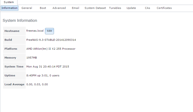

Robert..fair enough. I will try to provide more information. For starters, I believe that the old version was a FreeNAS stable 9.2. I am not completly sure on the exact version though. The new version is FreeNAS-9.3-STABLE-201412090314 . The system is a custom built box that has three drives in it. Two are large drives, and the third was for the os. I have attached a screen shot of gpart zdb and spool status. I am not sure about what kind of ram the system has, but there is two gigs. I attached a screen shot to help on that front also.
Also, the system has been up and running for over 8 months with no issues till today.
I realize that having two drives in one pool could be considered a mistake. I was shooting for more space, and it did work for some time.
About one hour before the system upgrade, I installed the Bacula system. Other than that, I did not alter any of the volumes or touch anything in the volume manager at all. That is what is driving me nutz. I also don't get how the system decided to put the other drive with the boot. I am attaching several screen shots to see if that can help.
Do you know of any way that I can remove it from the system boot? Since I will most likely loose everything, I am willing to try any command line options that come to mind.

You know FreeNAS 9.3 is not supposed to work properly with less than 8GB of RAM? From the above it looks as though your data could be intact on ada2, is there any data in /mnt/Media/? The only way I can see that you should get the mirrored boot drives and the single disk pool is if you installed FreeNAS 9.3 rather than updated, and then set up a new zfs pool on ada2.
