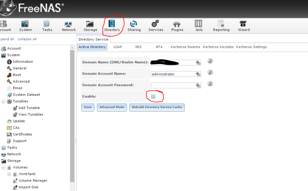

I have a physical FreeNAS 9.3 box with 24GB of ecc RAM, and dual L5630 CPU's that is having some weird issues joining a windows 2012 r2 level domain. When I first joined the domain, everything worked perfectly. I mapped some permissions out and was happy. I rebooted the server and now my issue is that I see no active directory users in the change permissions list. Domain Groups show up as normal. Browsing the SMB share doesn't work now due to the box being unable to resolve the users properly.
My box successfully joins the domain, "wbinfo -u" and "wbinfo -g" and "wbinfo -t" all return users, groups, and success respectfully. I went through the common troubleshooting tips listed in the manual
http://doc.freenas.org/9.3/freenas_directoryservice.html
with no fix including clearing the active directory cache and running the various commands. They all return an expected '0' code.
This is a nearly fresh reinstall of freenas where I basically configured networking on the box (dns, default gateway, etc) and then joined the domain. I can both forward and reverse lookup my domain controllers, and ping them fine. I went through and double checked that all relevant DNS SRV records were present on both my DNS servers.
Let me know which logs I should pull from and I will gladly upload them. Otherwise here is my console output:

I've experienced the AD service becoming disabled on a reboot. verify the checkbox is enabled. In fact, when I went to grab this screenshot, I noticed this box was disabled. grrrr.
I have been experiencing the same problem - whenever the server is rebooted, the "Enable" checkbox "unchecks" itself, and no clients can access the server until I log in to the GUI and reenable it manually.
Is there any workaround for this?

On follow up, I finally found another thread about it with a real answer. So much for telling myself I wouldn't look at this...
https://forums.freenas.org/index.php?threads/active-directory-users-not-showing-up-in-gui.26910/
Basically in the advanced settings you need to change idmap backend to rid rather than ad. This isn't even an option to view or change from the GUI in version 9.2.1.5-RELEASE from another server I have setup. So apparently they must not check between versions for how the previous config is setup? That or it is brand new and needs to be set...
