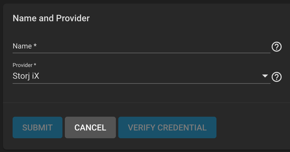

I'm on CORE 13-U3.1
I can't seem to configure it. When I choose iX Storj it does not give any options
Alecmascot
Mar 18, 2014
1,177
Youre mising the rh portion of the screen. Try clearing the browser cache.
