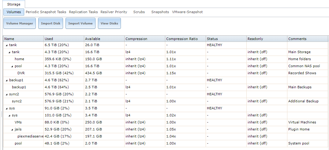

I am confused about an apparent mismatch in my zvol size vs the pool created inside it. I have 6 identical 6tb disks in raidz2, meaning 4 are really storage and 2 are allocated as parity.
Freenas shows the overall volume as 26TB but the pool inside is only 16.6TB.
Neither number really adds up, to me. There are no snapshots on the volume. Can anyone explain the discrepancy? I know there is some difference between Tib and Tb but it's not enough to account for the differences here. 6x6Tb should be closer to 36TB than 26, and I seem to lose another 10TB by going to a storage pool volume. I would have expected to have between 20 and 24 TB in the pool, about 36 TB in raw storage, and 12 in parity. But none of these numbers is even close...

The GUI I am looking at that confuses me is

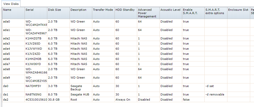

The overall size of "tank" doesn't add up. There is nothing obviously wrong here but the storage isn't adding up. Disks are:
The WD Green disks are in the "sys" volume (mirrored) and all the Hitachis are used in "tank" (raidz2)
Sure it does. The first line shows a raw pool capacity of 6.5 + 26 = 32.5 TiB, which is just right for 6 x 6 TB disks (accounting for the fact that 1 TB = 0.909 TiB). The second line shows a "net" capacity of 4.3 + 16.6 = 20.9 TiB, which sounds about right accounting for overhead.

I had forgotten about the TiB vs TB mismatches. Thanks, I just wanted to ensure I hadn't done something wrong.
Plus I was reading the status output wrong. I was subtracting used from available (as though available was total), which made things seem even worse.
It seems much clearer now
