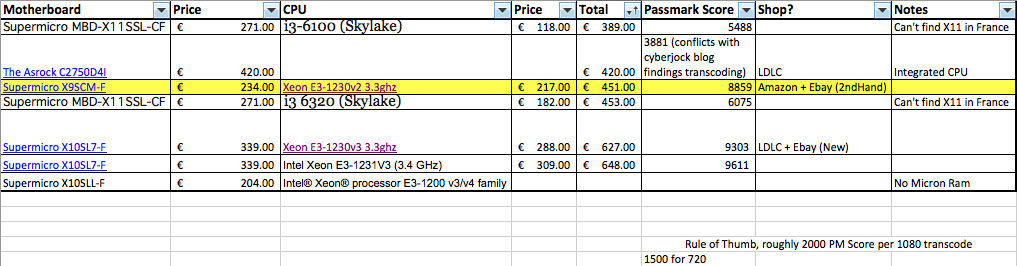

So I made and attached an excel spreadsheet screenshot on what I think my options are and the price I have found in euros. It still seems that the Xeon E3-1230v2 x9 combo is the best option price/benchmark (i do realise benchmark isn't everything). But to be honest, I am quite confused at the moment and not sure if:
- I should buy the Xeon E3-1230v2 and X9 motherboard or if I should get a more recent cpu and motherboard?
- Is there any benefits I am missing about having an up to date cpu and motherboard?
- If I should buy a second hand cpu off ebay?
- I reckon 20GB ram for the plex jail and a vm running handbrake should be enough, am I right?
- Does my upgrade plan of 4 4tb drive raidz2 and then another 4 drives later on sound good?
- Is my idea of handbrake in a vm silly or does it sound doable?
Pricing has been stable for the older generation stuff, so I find it rather unattractive. X11 is still oddly difficult to come by in Europe, I had to get my X11SSM-F from sona.de. It's decent service, but don't buy memory from them, they don't ship it well.
What I don't understand is why you're jumping for boards that have LSI SAS controllers. If you're planning to boot from USB, an X11SSM-F will happily take eight drives without an SAS controller. If you want to boot from an SSD, you can still add an SAS controller later, with slightly less favorable pricing - which might make sense, depending on how far off the second vdev is.
There's not too much to go wrong on a CPU, assuming the seller is honest.
My recommendation is to start at 16GB and add more later, if and as needed. Also, stick to the highest density DIMMs available (8GB for X9/X10, 16GB for X11).
Sure.
It'll be easier with FreeNAS 10. In 9.10, you need to either get handbrake running in a jail or run in a VM with virtualbox.
Thank you for recommending sona.de, I think Germany will be a good option for shipping to France (I know that some french friends who built gaming PCs got their hardware from Germany). I looked up X11SSM-F on sona.de and they are selling it at 240€ and the Xeon 3.4GHz E3-1230v5 at 285€, does that seem like a good choice?
Since you said that I decided to go back on ebay. Since sona.de seems like a good choice for motherboard and cpu, I looked for a PSU. I was initially going to go with fractal design R4 that I can get for 100€, but then I saw a Supermicro SC933S2-R760B on ebay for 194€. Considering jgreco recommends (as a quick rule of thumb) the SeaSonic G-550 for 8 drives on a xeon E3 v3, which would cost me in France roughly 115€. I was thinking that this 3U chassis and 760W Triple-Redundant AC power supply would be a good deal in the long-run, considering I intend to expand to 8 drives later on. But then the X11SSM-F is a 9.6" x 9.6" Micro-ATX and the SC933S2-R760B is for 12" x 13" E-ATX and 12" x 10" ATX. But since the chassis supports bigger motherboards than the motherboard I intend on buying is this such a problem? Or can it not be worked around easily (this is probably the worst question I have asked, sorry if it is simply no).
I searched the forum and found that in 2014 you and cyberjock said that it was ok to use one ram stick and upgrade to a second ram stick later. Would you still recommend buying one 16GB ram stick now and buying another 16GB ram stick possibly when I expand to 8 drives?
Will it be easier in FreeNAS 10 because of "the new bhyve VM hosting mechanism in FreeBSD 10" that will replace plugin/jails?
Yeah.
That thing looks like it predates SAS, which would seriously complicate things, since you'd need to replace the backplane (if such a replacement is even available).
If you end up with a backplane that has an SAS expander, you will need an SAS controller. Supermicro also has backplanes without expanders, which you can use with SATA controllers (and, for instance, use a separate SAS HBA + expander later when you want to use more than eight drives).
