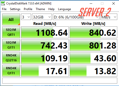

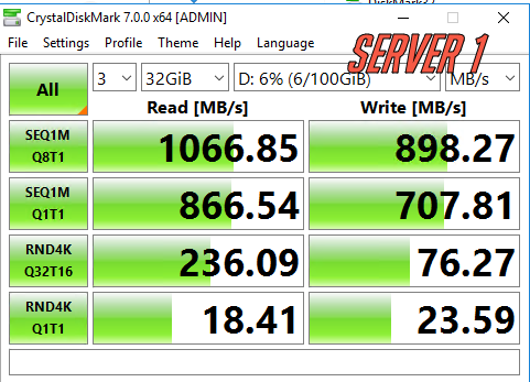

and from within a VM
Rand

I did run two test on two VM's on seperate hosts the same time. Looking at the reports, I think I hit a CPU limit. Reporting within FreeNAS shows I hit 9GPS. Guessing this means my hardware can perform to the limit of the network?

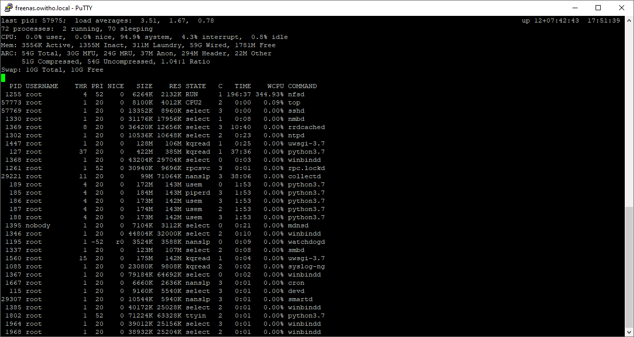

top ideally while you run two concurrent tests
Still working on getting this setup. does the local DD showing above help with this? are you trying to confirm If i'm CPU bound?

hopefully this is what you are looking for. i took the TOP screen capture at the lowest point

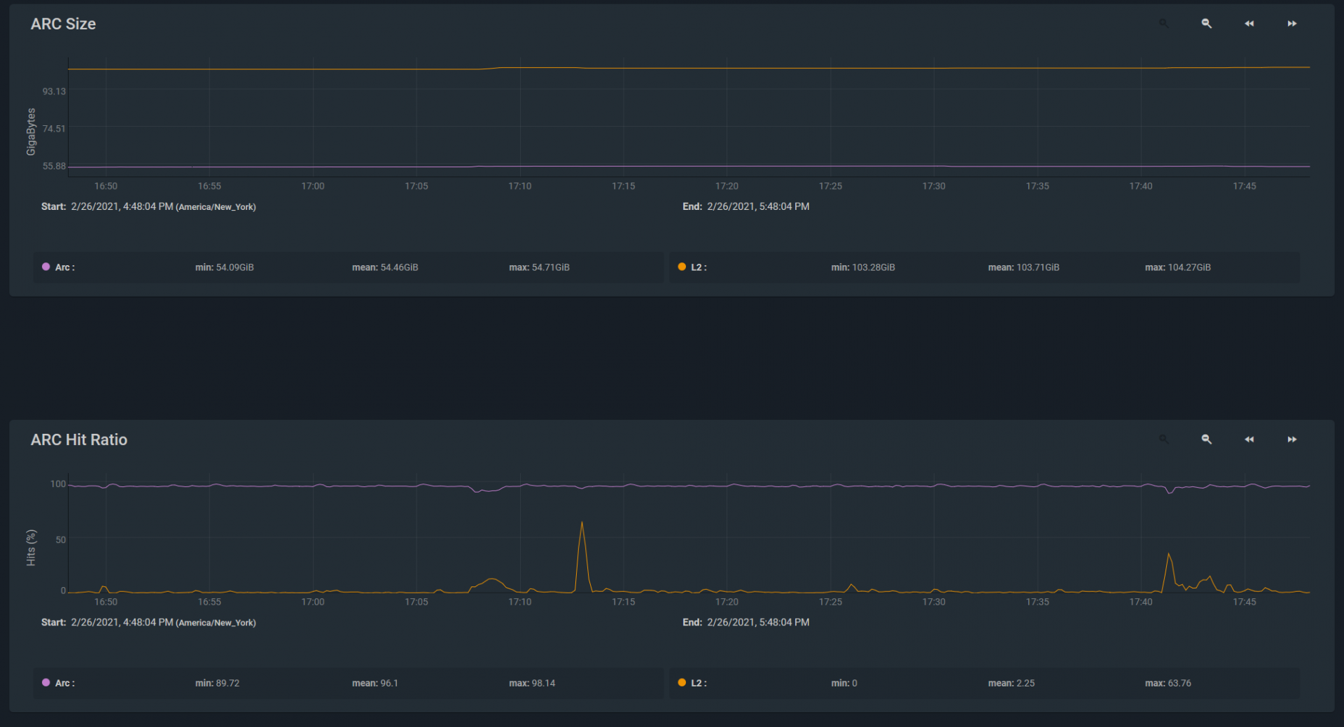

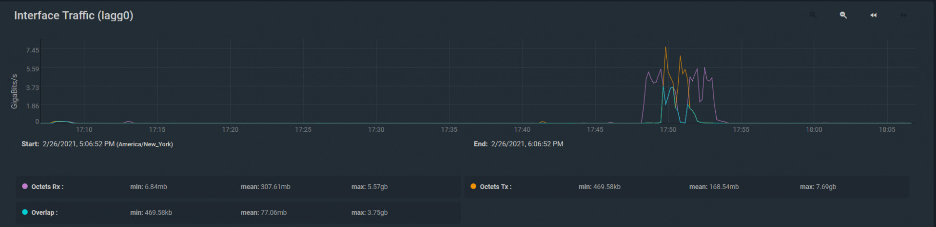

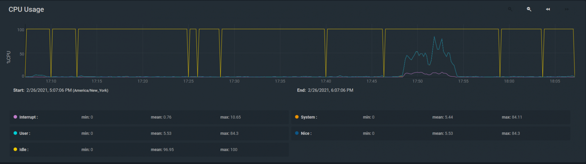

here is the FreeNas side of things.

Well if you look at the top output you're at 350% cpu usage , so basically 3,5 cores@100%
I would say thats indeed close to maximum what the CPU can do, so at this point thats your limit.
Your network seems to have some headroom, so you might be able to squeeze some more out of it if you replace your CPU (8350k maybe) but I don't think thats worth it at this point, your components seem to be well matched.
