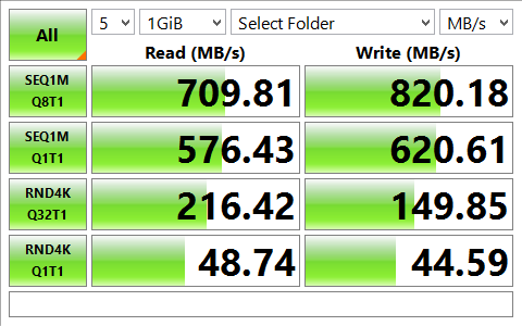

Current performance:
SMB ( CIFS )
- Read: 5.9 to 6 Gbps
- Write: 6.8 Gbps
iSCSI is similar.
FTP ( plain, unencrypted )
- Read: 7.1 Gpbs
- Write: 7 Gbps
Any help on how to configure FreeNAS to reach 10 gigabit is appreciated!
