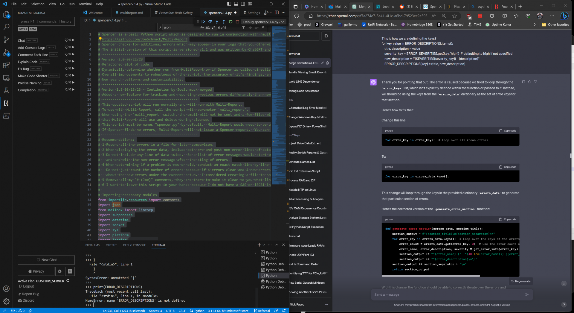

Mostly still ChatGPT more than me. But I've started using https://refact.ai/ in Visual Studio Code to help me out alot too.
I'm trying to learn Python from ChatGPT while also solving problems...and I am introducing more tools into my workflow to help me become a better programmer.
At this stage in my development, I feel like I'm playing the Job's to "AI"'s Wozniak but way crappier than Apple. Pretty sure I will ever measure up to either lmao.
