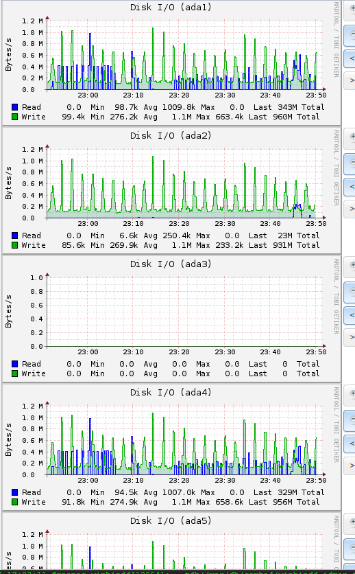

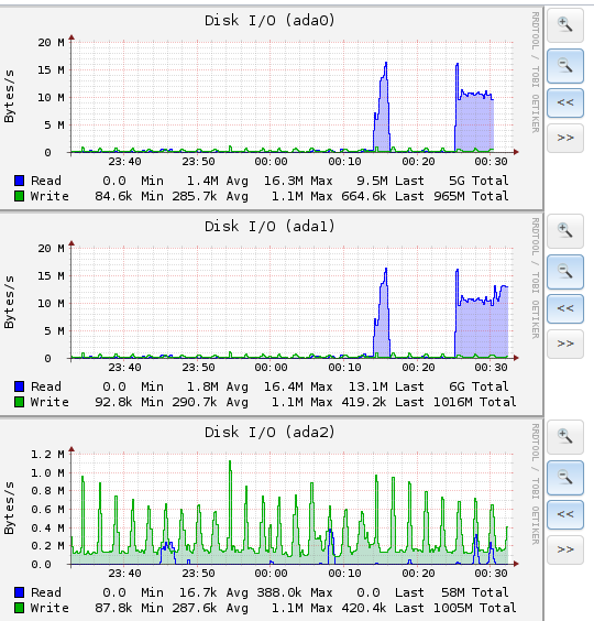

The system is running now, though I'm seeing some odd non-uniform disk behavior in the gui that seems...not quite right either. ada2, the disk which finished resilvering, is getting activity missing many of the reads that are happening across the pool right now (which is playing some video files among other things). I am guessing this is because the system has been serving the same video files for a while and maybe it was already setup to read off the arc/those disks before the resilver completed? ada0 and ada5 look the same as 1 and 4. ada3 is the currently offlined disk. Kind of guessing here, I'll see if the behavior persists. Is there any other post-resilver zfs/freenas activity of any kind expected that would cause this read imbalance? I'm used to seeing write and reads uniform across all disks pretty much at all times.

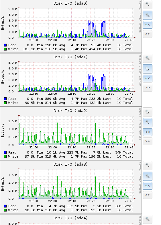

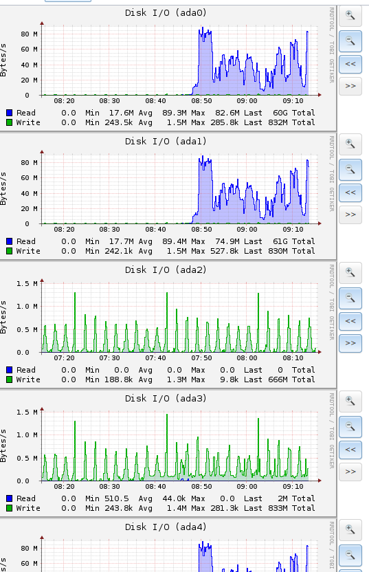

Yeah, something still seems goofy with ada2. Started a big transfer to a desktop machine, ada2 not participating in array read at all. gstat output agrees, showing no reads at all.
All highpoints are to be avoided. Not a single one of them has proven reliable in FreeNAS in all these years. Even when they specifically tried.

Ok, so after the above, I wrote some new data to the pool, and read it back. The ada2/3 did receive this data and read it back. I read existing data off of the pool, and ada2/3 show NO read activity.
I kicked off a scrub, and ada2/3 are not being read from at all...
Is this in any way expected behavior????
No, not if they're part of the pool being scrubbed.
Well, technically, if they had been added to the pool later as a new vdev they would probably see less activity, at least at first.

Update for anyone following or having similar issues in the future.
ada2/3 never really did much through that scrub. However, after the scrub completed, they were fully participating in array reads and write of even old files. The zpool status at the end of the scrub still showed the old checksum errors at the pool/vdev level, but no known data errors (since I had deleted the corrupted file).
I did a zpool clear, and the array seemed to be fine, no new resilvering or anything. I scrubbed again, this time all disks showed read activity throughout the scrub, and it completed with no errors/repairs. I rebooted, and the system came back up just fine, no resilvering restarted or anything.
I then offlined the next disk in my array replacement plan (ada4), and replaced it; it's now resilvering, and everything seems fine.
I am still not 100% sure what was going on, but something about the presence of that corrupted file and/or the checksum errors at array level was preventing the resilver from being fully completed until after the file was removed and the array scrubbed. In my research, I did see some anecdotal statements that zfs will not/cannot fully complete a resilver when there are pool or vdev level errors on the array, so that could have been the issue, and deletion of that corrupted file and scrub made those new disks fully trusted.
In any case, things are looking pretty much back to normal. Assuming the last two disk replacements go well, I'll be upgrading to freenas 11.2 and getting a replacement hba for this highpoint controller. Looks like the LSI SAS2008 or SAS2308 based cards are still the go-to recommendation there, yes?

Final update (a few weeks late):
Last two drive replacements went fine, and array is running normally with the expanded size.
Must have been some kind of persistent issue due to the checksum errors that occured when resilvering ada2. Once I'd cleared those and the bad files, and allowed things to scrub, everything was back to normal.
