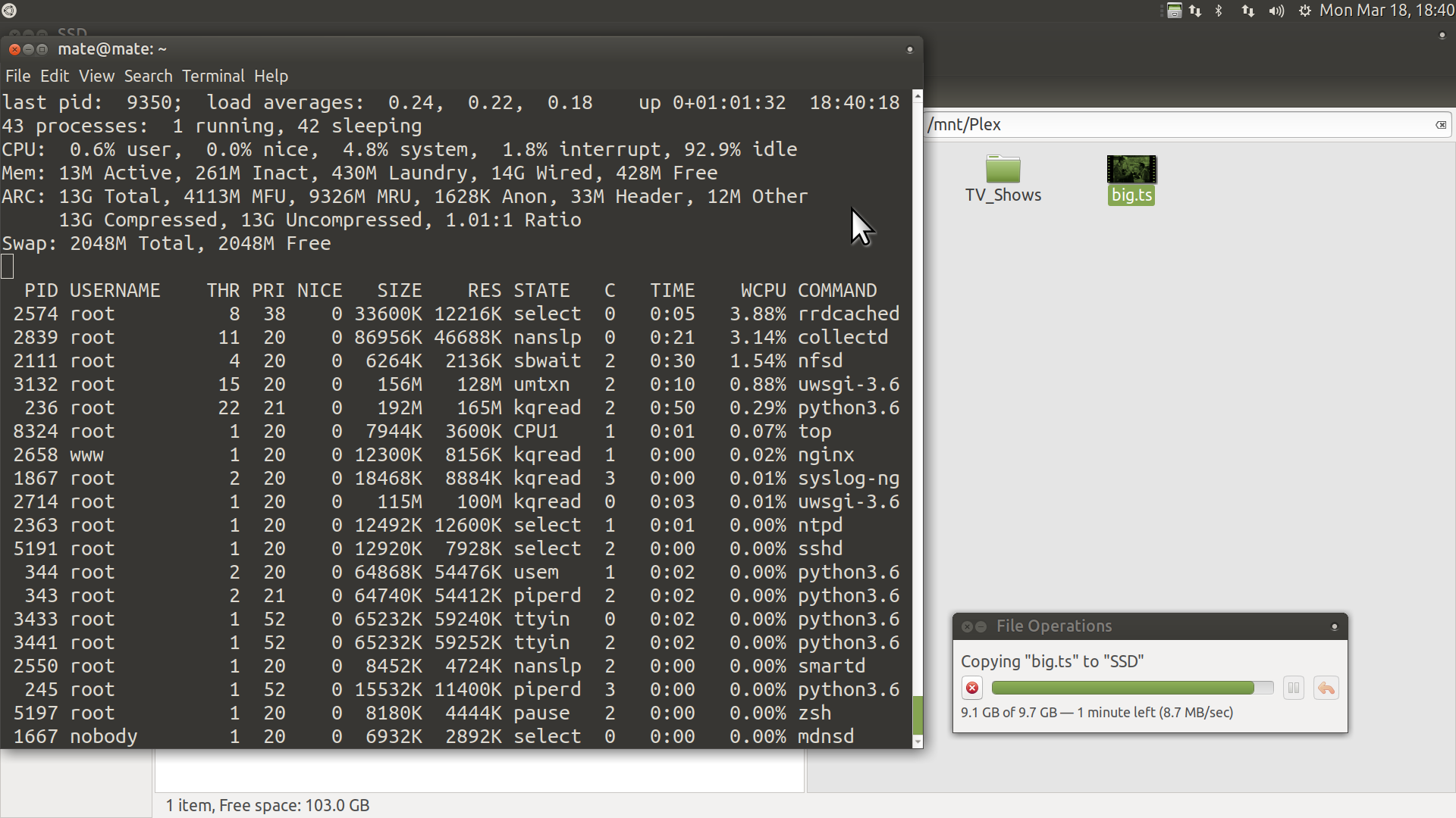

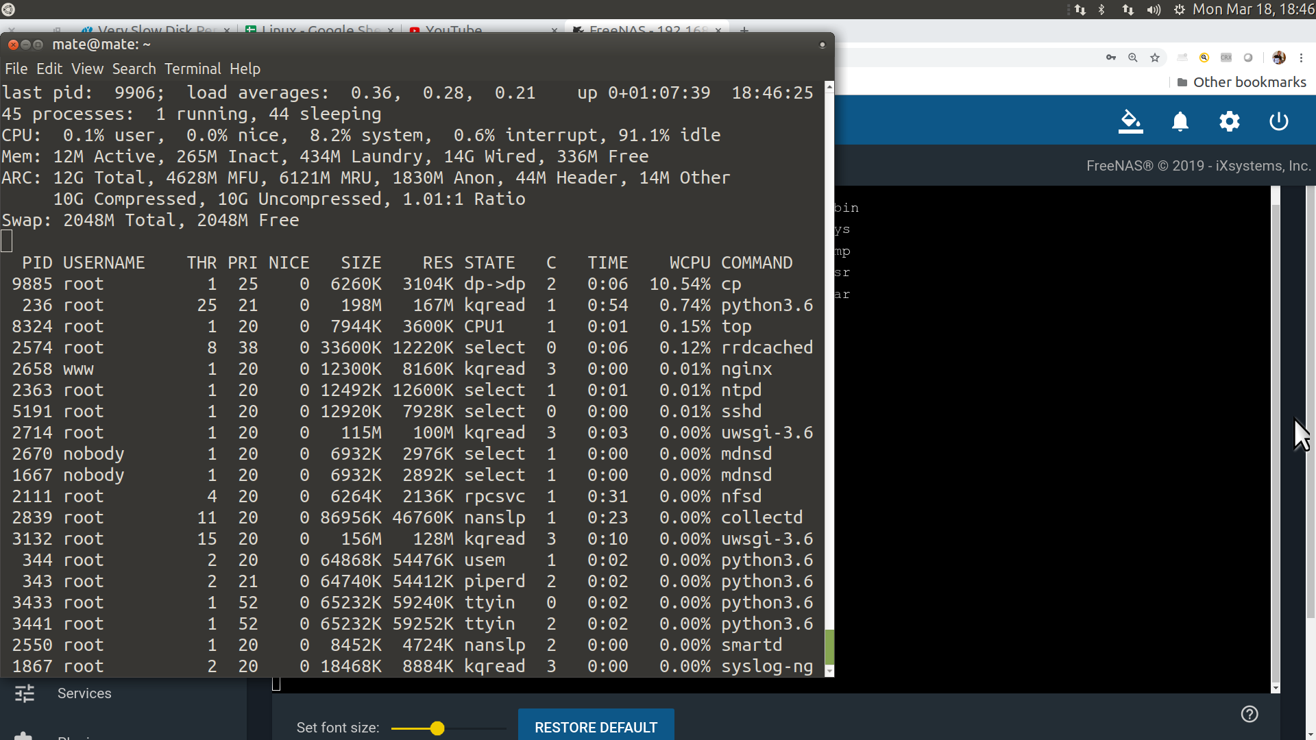

I did a test tonight. using a 9.7GB movie. Using the file manager on my mate system I copied it from the SSD on the FreeNAS to the Mirrored pool on the FreeNAS... took forever... over 9 minutes. I then logged into the FreeNAS by SSH from the mate computer. I used the copy command to copy the file from the folder one way.. and then back the other way. It took about a minute and twenty seconds each way.
This is what I'm thinking.. tell me what I'm missing if I have it wrong..
1. The drives are performing normally.. because by command line they transfer quickly.
2. Things I try to do over the network are extremely slow.... reasons?
Reason 1... the Realtek NIC
Reason 2... The FreeNAS OS does not work well with my MB or Memory... (I don't know enough about the OS and how it copies things... is it using the same commands behind the scenes I used from command line?)
I had TOP running under all tests.. system was using very little resources on memory or cpu from what I co
uld tell. I did take a few screen shots.
One above is from when requesting over network.
This one is from when doing it using command line.

It doesn't seem like it could be network... the progress bar on the mate machine.. for a smaller file... 2GB or under, goes right over (because it is going into memory on the FreeNAS initially).. Then takes several minutes to clear.... A large file.. 9.7GB.. starts off the same... then at about 3GB you see the transfer speed steadily decrease until it's only around 11 MB/s.. so it seems to indicate a ZFS slow down... I'm trying turning off the sync again after I get things set up again.. and will do some more iperf3 tests. It may just be the hardware doesn't play nice.. but I'm not ready to give up on it yet. I've got some time to work on it before I need to start using it.
