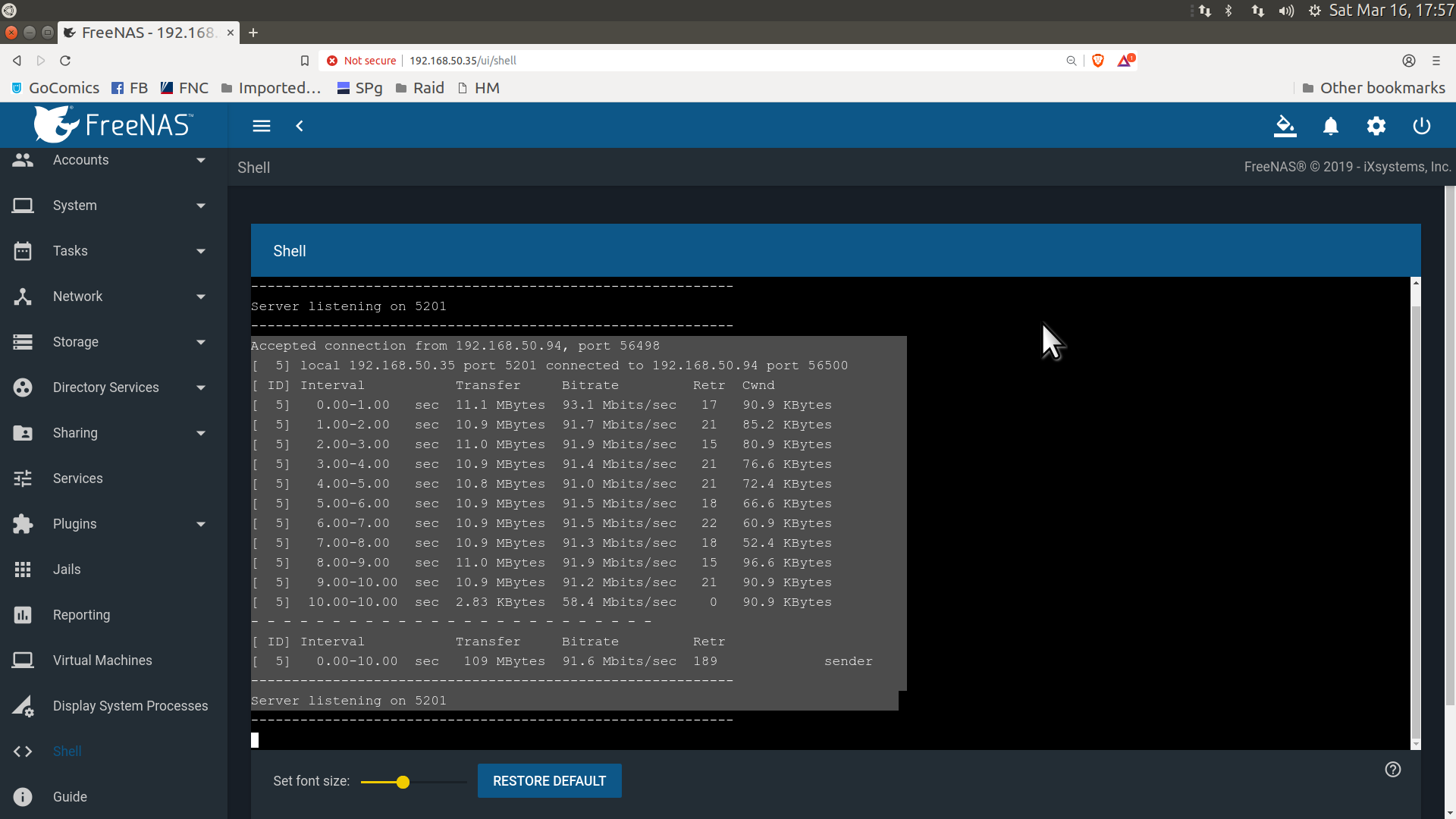

not able to copy and paste from the browser showing run in FreeNAS..
First 10 lines.. each one second
Transfer Bitrate Retr Cwnd
11.1 MB 93.1 MBits/sec 17 90.9 KBytes
10.9 91.7 21 85.2
11 91.9 15 80.9
10.9 91.4 21 76.6
10.8 91.0 21 72.4
Rest were similar - I edited and attached a screen shot
I updated my signature with system information

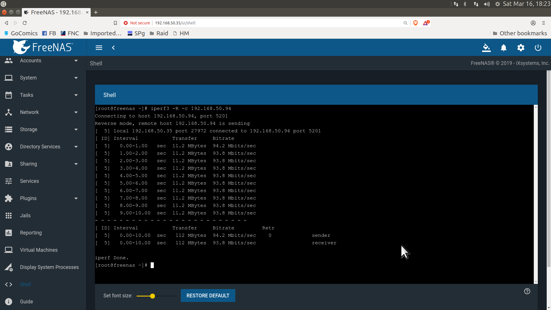

Running iperf3 -s on the ubuntu and running it the other way I get this on the ubuntu -
Accepted connection from 192.168.50.35, port 31825
[ 5] local 192.168.50.94 port 5201 connected to 192.168.50.35 port 27972
[ ID] Interval Transfer Bandwidth Retr Cwnd
[ 5] 0.00-1.00 sec 8.41 MBytes 70.6 Mbits/sec 0 80.6 KBytes
[ 5] 1.00-2.00 sec 11.2 MBytes 93.8 Mbits/sec 0 80.6 KBytes
[ 5] 2.00-3.00 sec 11.2 MBytes 93.8 Mbits/sec 0 80.6 KBytes
[ 5] 3.00-4.00 sec 11.2 MBytes 93.8 Mbits/sec 0 80.6 KBytes
[ 5] 4.00-5.00 sec 11.2 MBytes 93.8 Mbits/sec 0 80.6 KBytes
[ 5] 5.00-6.00 sec 11.2 MBytes 93.8 Mbits/sec 0 80.6 KBytes
[ 5] 6.00-7.00 sec 11.2 MBytes 93.8 Mbits/sec 0 80.6 KBytes
[ 5] 7.00-8.00 sec 11.2 MBytes 93.8 Mbits/sec 0 80.6 KBytes
[ 5] 8.00-9.00 sec 11.2 MBytes 93.8 Mbits/sec 0 80.6 KBytes
[ 5] 9.00-10.00 sec 11.2 MBytes 93.8 Mbits/sec 0 80.6 KBytes
[ 5] 10.00-10.28 sec 3.17 MBytes 94.1 Mbits/sec 0 80.6 KBytes
[ 5] 0.00-10.28 sec 112 MBytes 91.6 Mbits/sec 0 sender
[ 5] 0.00-10.28 sec 0.00 Bytes 0.00 bits/sec receiver
Looks like the NIC on the FreeNAS is the problem because of all the Retrs?

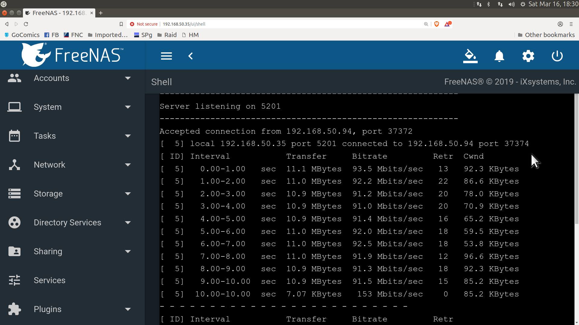

I noticed the screen shots were hard to read on the other files.. his is one of the FreeNAS machine when running iperf3 -s on it.
I think Retr means re-try? The number ranged from 13 to 22.. so if that is so, that is the problem, correct?

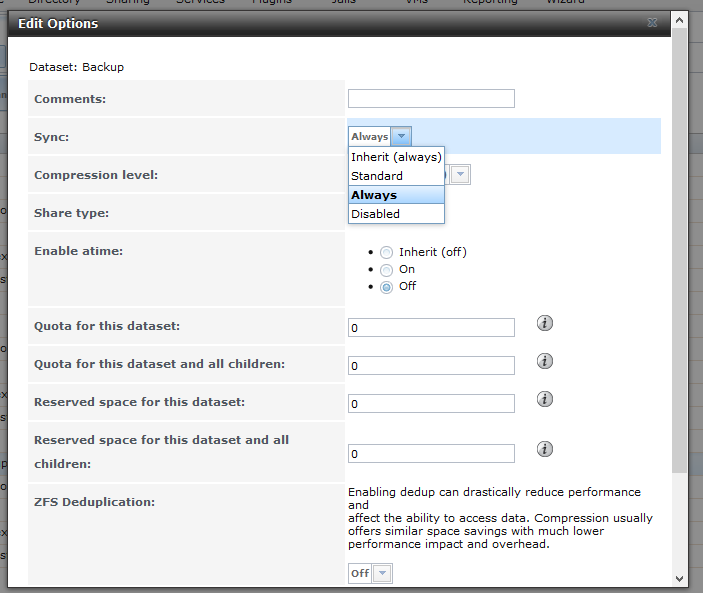

You could try disabling sync writes on the target pool to see if sync write performance is the source of your bottleneck.

Hrmm yeah that's the problem then. You're only getting 100Mbps.
I see Retr too of 300+ and can still saturate 1 gig. You could have a bad cable.
Try running ifconfig on FreeNAS and look for the media line. See if you're link negotiated to 100Mbps. One of my boxes says "media: Ethernet autoselect (10Gbase-T <full-duplex>)" for example (10gig interface). You'll need to look at the physical interface e.g. ix0 or ix1.
On Linux, run "ethtool eth0 | grep -i speed" (run ifconfig first to see what your primary interface is and replace eth0 with it). Mine shows "Speed: 1000Mb/s" for example.
If both show 1gig, try swapping cables anyway.

qxotic, do try what Stux suggested with regard to disabling sync write. It will allow you to determine if that is indeed part of the problem. If you find that it is, then you know that a SLOG device is the answer.

Ok.. had to learn SSH this morning for first time. Here is the data both ways from the Freenas system -
root@freenas[~]# iperf3 -R -c 192.168.50.94
Connecting to host 192.168.50.94, port 5201
Reverse mode, remote host 192.168.50.94 is sending
[ 5] local 192.168.50.35 port 33271 connected to 192.168.50.94 port 5201
[ ID] Interval Transfer Bitrate
[ 5] 0.00-1.00 sec 11.3 MBytes 94.4 Mbits/sec
[ 5] 1.00-2.00 sec 11.2 MBytes 93.9 Mbits/sec
[ 5] 2.00-3.00 sec 11.2 MBytes 93.9 Mbits/sec
[ 5] 3.00-4.00 sec 11.2 MBytes 93.9 Mbits/sec
[ 5] 4.00-5.00 sec 11.2 MBytes 93.9 Mbits/sec
[ 5] 5.00-6.00 sec 11.2 MBytes 93.9 Mbits/sec
[ 5] 6.00-7.00 sec 11.2 MBytes 93.9 Mbits/sec
[ 5] 7.00-8.00 sec 11.2 MBytes 93.9 Mbits/sec
[ 5] 8.00-9.00 sec 11.2 MBytes 93.9 Mbits/sec
[ 5] 9.00-10.00 sec 11.2 MBytes 93.9 Mbits/sec
[ ID] Interval Transfer Bitrate Retr
[ 5] 0.00-10.00 sec 112 MBytes 94.2 Mbits/sec 0 sender
[ 5] 0.00-10.00 sec 112 MBytes 93.9 Mbits/sec receiver
iperf Done.
root@freenas[~]# iperf3 -s
Server listening on 5201
Accepted connection from 192.168.50.94, port 38276
[ 5] local 192.168.50.35 port 5201 connected to 192.168.50.94 port 38278
[ ID] Interval Transfer Bitrate Retr Cwnd
[ 5] 0.00-1.00 sec 11.4 MBytes 96.0 Mbits/sec 13 109 KBytes
[ 5] 1.00-2.00 sec 11.2 MBytes 94.1 Mbits/sec 26 55.2 KBytes
[ 5] 2.00-3.00 sec 11.2 MBytes 94.1 Mbits/sec 19 62.3 KBytes
[ 5] 3.00-4.00 sec 11.2 MBytes 94.1 Mbits/sec 20 68.0 KBytes
[ 5] 4.00-5.00 sec 11.2 MBytes 94.1 Mbits/sec 21 70.8 KBytes
[ 5] 5.00-6.00 sec 11.2 MBytes 94.2 Mbits/sec 21 73.7 KBytes
[ 5] 6.00-7.00 sec 11.2 MBytes 94.1 Mbits/sec 20 78.0 KBytes
[ 5] 7.00-8.00 sec 11.2 MBytes 94.1 Mbits/sec 22 79.4 KBytes
[ 5] 8.00-9.00 sec 11.2 MBytes 94.1 Mbits/sec 21 85.1 KBytes
[ 5] 9.00-10.00 sec 11.2 MBytes 94.1 Mbits/sec 20 90.8 KBytes
[ 5] 10.00-10.00 sec 4.24 KBytes 118 Mbits/sec 0 90.8 KBytes
[ 5] 0.00-10.00 sec 112 MBytes 94.3 Mbits/sec 203 sender
And here are the results from the mate system -
mate:~$ iperf3 -s
Accepted connection from 192.168.50.35, port 13148
[ 5] local 192.168.50.94 port 5201 connected to 192.168.50.35 port 33271
[ 5] 0.00-1.00 sec 8.43 MBytes 70.7 Mbits/sec 0 60.8 KBytes
[ 5] 1.00-2.00 sec 11.3 MBytes 94.8 Mbits/sec 0 60.8 KBytes
[ 5] 2.00-3.00 sec 11.2 MBytes 93.8 Mbits/sec 0 60.8 KBytes
[ 5] 3.00-4.00 sec 11.2 MBytes 93.8 Mbits/sec 0 60.8 KBytes
[ 5] 4.00-5.00 sec 11.2 MBytes 93.8 Mbits/sec 0 60.8 KBytes
[ 5] 5.00-6.00 sec 11.2 MBytes 93.8 Mbits/sec 0 60.8 KBytes
[ 5] 6.00-7.00 sec 11.2 MBytes 93.8 Mbits/sec 0 60.8 KBytes
[ 5] 7.00-8.00 sec 11.2 MBytes 93.8 Mbits/sec 0 60.8 KBytes
[ 5] 8.00-9.00 sec 11.2 MBytes 93.8 Mbits/sec 0 60.8 KBytes
[ 5] 9.00-10.00 sec 11.2 MBytes 93.8 Mbits/sec 0 60.8 KBytes
[ 5] 10.00-10.27 sec 3.16 MBytes 97.0 Mbits/sec 0 60.8 KBytes
[ 5] 0.00-10.27 sec 112 MBytes 91.7 Mbits/sec 0 sender
[ 5] 0.00-10.27 sec 0.00 Bytes 0.00 bits/sec receiver
^M^Ciperf3: interrupt - the server has terminated
mate@mate:~$ iperf3 -R -c 192.168.50.35
Connecting to host 192.168.50.35, port 5201
Reverse mode, remote host 192.168.50.35 is sending
[ 4] local 192.168.50.94 port 38278 connected to 192.168.50.35 port 5201
[ 4] 0.00-1.00 sec 11.2 MBytes 94.1 Mbits/sec
[ 4] 1.00-2.00 sec 11.2 MBytes 94.1 Mbits/sec
[ 4] 2.00-3.00 sec 11.2 MBytes 94.1 Mbits/sec
[ 4] 3.00-4.00 sec 11.2 MBytes 94.1 Mbits/sec
[ 4] 4.00-5.00 sec 11.2 MBytes 94.2 Mbits/sec
[ 4] 5.00-6.00 sec 11.2 MBytes 94.1 Mbits/sec
[ 4] 6.00-7.00 sec 11.2 MBytes 94.1 Mbits/sec
[ 4] 7.00-8.00 sec 11.2 MBytes 94.1 Mbits/sec
[ 4] 8.00-9.00 sec 11.2 MBytes 94.1 Mbits/sec
[ 4] 9.00-10.00 sec 11.2 MBytes 94.1 Mbits/sec
[ 4] 0.00-10.00 sec 112 MBytes 94.3 Mbits/sec 203 sender
[ 4] 0.00-10.00 sec 112 MBytes 94.2 Mbits/sec receiver
I will work on running more of the tests today.
Thank you.
How do I do this? I tried setting sync to disabled but get a call error when I try to save it, says to set it to none, which is not one of the three options.. it is set on Standard, the only other option is always.
Thank you.
