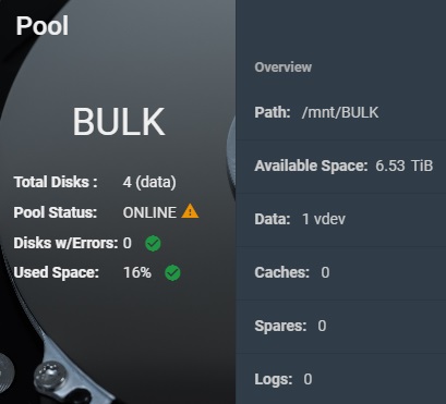

This was intended to be a low cost workstation backup server for the client. But according to the SMART results, these seagate drives went from "new" to almost dead in about a month. They are configured in a RAIDZ(1) with lz4 compression (default pool setup otherwise).
The only issue I've been running into with this server has been some random reboots, that made me suspect the old PSU was failing. I was waiting to fully diagnose/replace that until I could find more info as to what's going on with these drives. Data transfers to/from the server during setup and initial testing have been working fine and quite fast given the age of the other hardware (other than when the random reboots strike obviously).

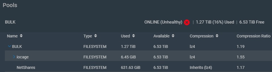

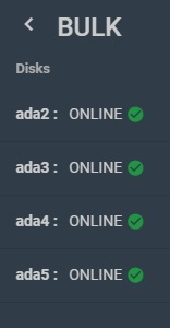

Mostly #1/#5/#7/#195. I guess I'm just not used to the Seagate reporting. I also have a weird error state in TrueNAS that I've never seen before. I've tried researching it but kept finding scenarios that were different from mine in some regard.
After looking at the smart results I kinda just figured the error states displayed in the UI were the result of the drives being in poor health.

You can check in the terminal itself:
zpool status -v BULK
Thanks, I was researching that separately, and was almost there. Checksum errors, permanent failures on a couple of non-essential files in the pool. Cleared; points back to errors probably caused by the random reboots and failing PSU.

For sure, just did a zpool clear, deleted the corrupted files, and started a scrub. This server is still just in testing. Nothing critical stored anywhere on it. Will see how the scrub goes, replace the PSU and go from there.
