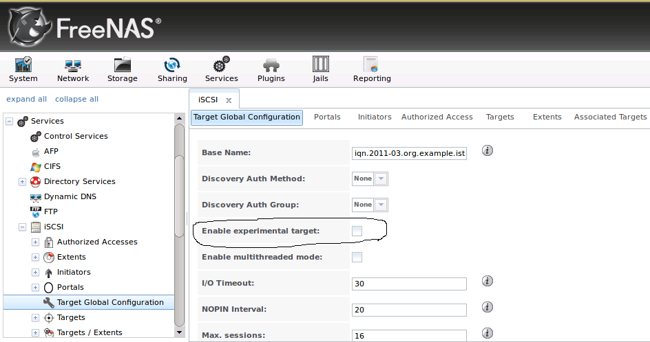

At what version software I can find the check box for experimental target mode?
nicolaus
Mar 17, 2015
3
Only in later 9.2.1.x. It was enabled by default and removed in 9.3.
Thank you, well than if I want to enable FC Target I will need to do only this steps:
  1. # mountrw / && sed -i "" -e 's/\(role\)=2/\1=1/' /boot/loader.conf && mount -ur /
Create a postinit script that runs /usr/sbin/ctladm port -o on
How I can check out that all is ok?
