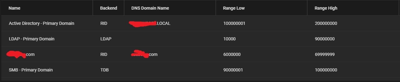

Hi guyes. I'm sorry to bring old post for new life. And Im sorry if I bother you. But there is lack of info in Truenas manpage about these.
Can you help with litle much info about this
"If you're configuring trusted domains, you _must_ generate an explicit idmap configuration for the trusted domain and add it as a series of auxiliary parameters under Services->SMB. Although it is possible to use "authenticated users" to grant these permissions"
I have 2 AD domain controler for both organisations . one is .local (is my primary) second is .com. These two domains is in trusted 2 way mode. My goal to use TrueNAS for both organisations. I want to create different datasets one for .com other for .local and third for .local and .com. They will be accessed through trought SMB shares.
So:
Do they both have to be with RID backend (one is 2012R2 and second is 2008R2 MS servers)
These are my settings, but I'm not sure if they are correct.
I understand that RID mapping should not overlap.
Do I have to change the range of the domain controllers themselves and make it the same in these settings?
How is this done?
What should I enter in the auxiliary parameters section
idmap config **** .COM: backend = rid
idmap config **** .COM: range = range from the second domain
Are they entered correctly?
Any info will be priceless. Thanks a lot for helping the newcommer.

You need short-forms of names. If you type wbinfo -m with samba started you should see a list of names

First thanks a lot for fast response.
When I type wbinfo -m with samba started I have a list of NetBIOS name (in my case NAS), short name of PDC and short name for second DC. What to do next?

Hello everyone. Sorry for the embarrassment. I managed to deal with my problem and that's why I want to share the solution so that it remains as some kind of knowledge. I especially want to thank @turboaaa for the help he gave me. It turns out that I don't need to set up a second RID for the second domain. I need to strip my ACLs and add the second domain to the Kerberos Realms menu. This solved the problem in general.
The problem with doing that is that now your SID<-> ID mapping is non-deterministic for the trusted domain. This means permissions can break potentially at any time on it and cannot be easily reproduced if you rsync or replicate data to another server. The correct domain name to use for trusted domains is the short-form name as returned in wbinfo -m.

Hm. anodos please give me little more info, about it. I will describe step by step what i did till now.
1. Trusted 2 domains two way. Every user from both domains can auth in other one.
2. Domain "A.local" is primary in TrueNAS. Domain "B.com" is secondary.
3. When I type wbinfo -m i have:
BULTIN
Name of TRUENAS STORAGE (just NAS)
Name of 1-st domain (just A without .local)
Name of 2-nd domain (just B without .com)
When I set samba ACL i set it in this way: A\domain admins or B\domain admins. This is a short name from wbinfo -m
I dont use: A.local\domain admins or B.com\domain admins if you mean that. If you dont have mean that.... may be Im too stupid to understand what you say me :(
p.s.
OK. I set second RID, range is not overlaped. Im using short name without .com when I set it. May be this is the missing part of puzzle?
