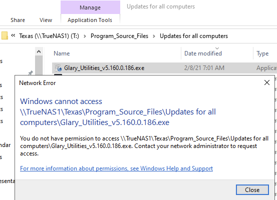

I first noticed that all wasn't well when I couldn't install a program file that was saved on the server. I have to copy the exe to the workstation to install. I usually keep copies of updated programs on my server and once a month update all the out of date programs on a workstation. Think Firefox, Thunderbird, Glary Utilities, Libre Office... That worked fine with the FreeNAS, but not on the TrueNAS machine. Next I noticed that I cannot open files from the TrueNAS machine using command line from a windows machine. I can with the old FreeNAS Machine. I posted a thread about this but never got a solution. See... https://www.truenas.com/community/t...ne-cant-open-from-cmd-line.90347/#post-626636

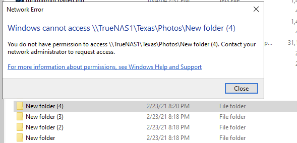

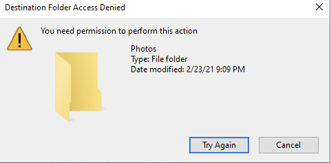

Today, I found a new problem that is even more serious. Something has changed. When I try to create a new folder on the TrueNAS machine, Windows immediately give me an error saying "Destination Folder Access Denied"... "You need permission to perform this action."
It goes ahead and creates a folder named "New folder" but I can't access it. I can't delete it. I can't even view security permission for it. I get this error:
Now, this gets weirder, I can add folders under different subdirectories that I can read and write to.

The multiple folders thing is symptomatic of user having permissions to write data, but not write attributes and extended attributes. Can you post getfacl output for each path component leading to the share?

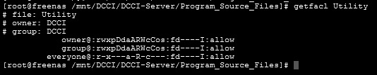

Here is how the permissions are set on my Photos Directory on the old server:
Here is how the permissions are set on my Programs Source File Directory on my old server:

Okay. Looks like issue is caused by the ACL set on /mnt/Texas-29-Z2. It's generally best practice to create datasets and share those out rather than sharing the your zpool mountpoint.
You can fix by running the following command
setfacl -m owner@full_set:fd:allow,group@full_set:fd:allow,everyone@:rxaRc:fd:allow /mnt/Texas-29-Z2
Then you can verify that it's correct by running the command getfacl /mnt/Texas-29-Z2.
If "photos" is a ZFS dataset then you can use the ACL editor for the dataset to grant owner@, group@, and everyone@ relevant permissions (perhaps FULL_CONTROL), and set FLAGS to "BASIC: INHERIT". In this case you can apply recursively.
If "photos" is an SMB share, then you can do the same through the share filesystem permissions editor.

Sorry. Forgot the extra colons in that setfacl command.
setfacl -m owner@:full_set:fd:allow,group@:full_set:fd:allow,everyone@:rxaRc:fd:allow /mnt/Texas-29-Z2

Thanks you so much for helping me. Making progress. I was able to change the permissions on those newly created directory and then I could get rid of them from Windows.

I have a directory on the server where I keep all my program updates. I can't update any computer by running those exe's from the server.
Is this a windows permission issue instead of a TrueNAS issue? I can perform this action on my old FreeNAS machine no problem.

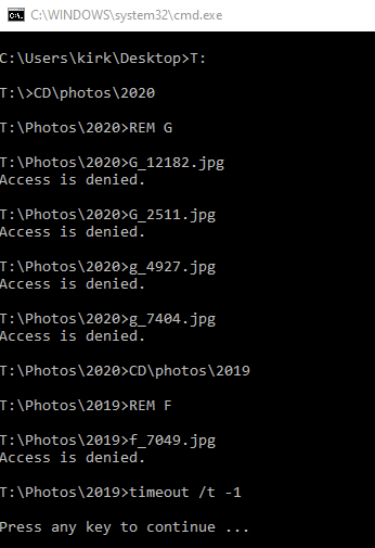

That other issue that I have... I have a DOS bat file that I use to open multiple photos from my server. The batch runs fine on the old FreeNAS machine, but fails on the TrueNAS machine.
Thanks again. :)
You'll most likely need to fix permissions server-side through GUI ACL editor. Same sort of operation I described earlier. Grant owner / group full control (with inherit) recursively as earlier. The setfacl command I gave you was non-recursive because we don't want to break permissions on jails or other things.
