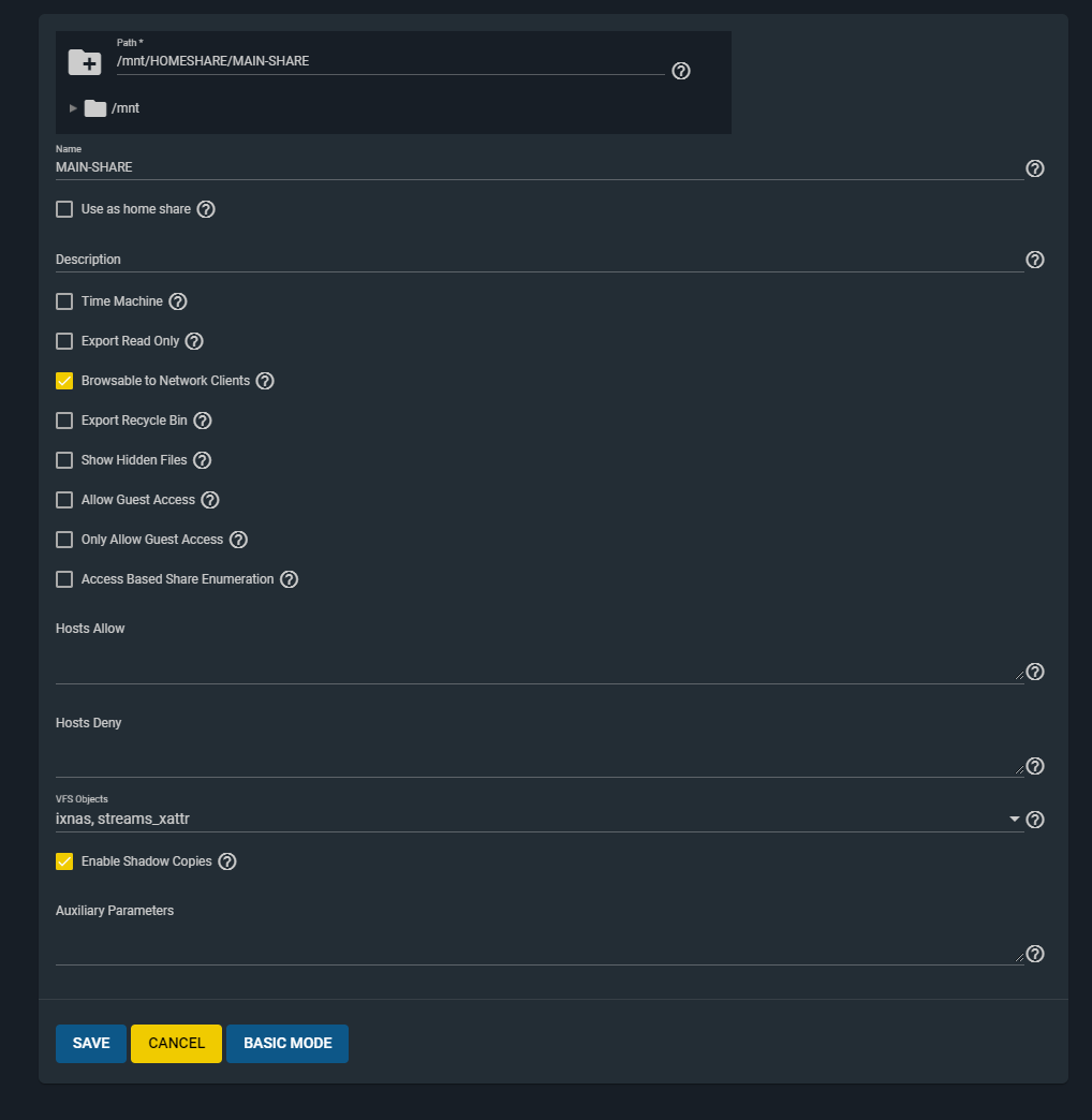

SMB Share main-share, running on homehare pool - I have included screen captures of the settings and ACL setup for the share
SMB Share plex-media, running on mediashare pool - configuration is identical to main-share

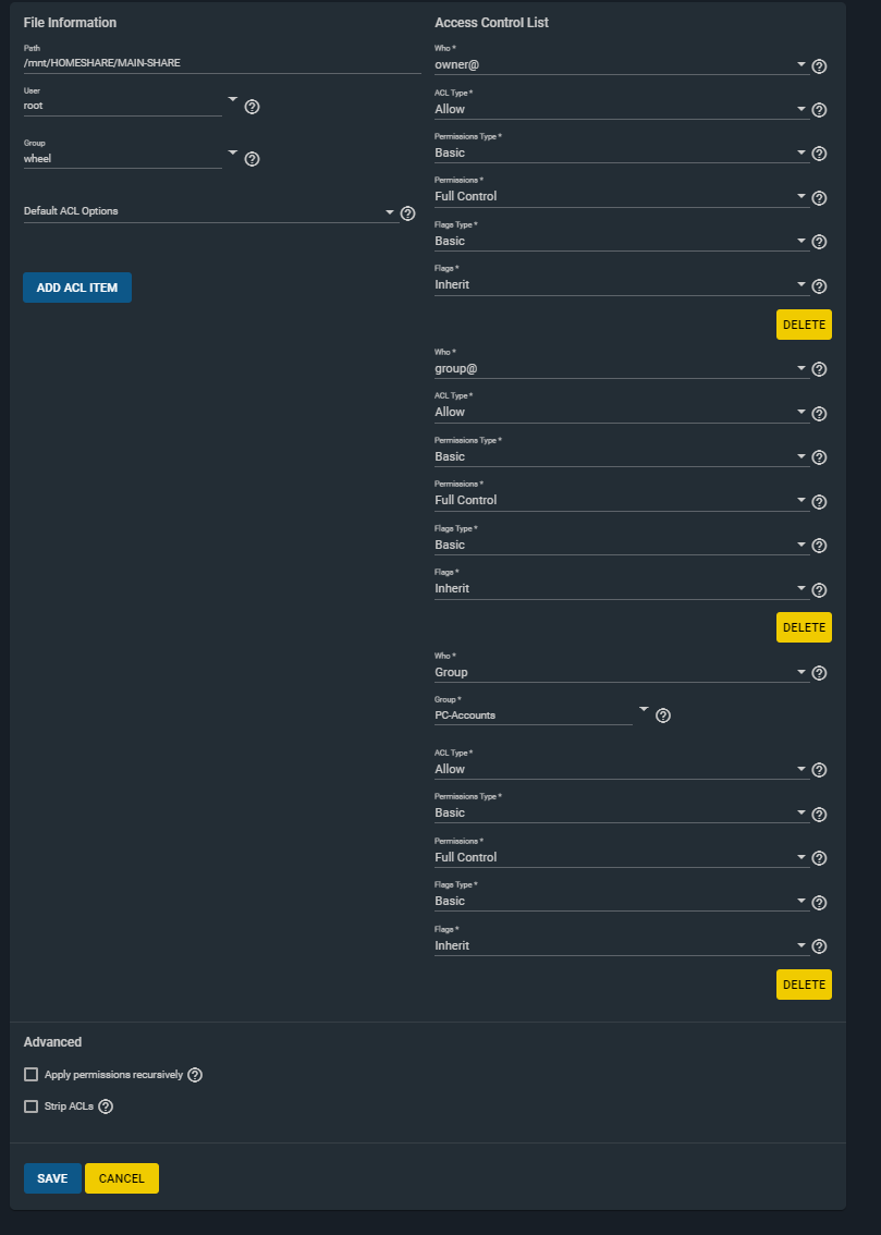

I have 2 users set up, both members of the PC-Accounts group (the PC-Accounts group has "full control" permissions to the share&pool). A screen capture of one user's config is included below. Both are set up as "Window's accounts", with the email matching the Microsoft account email of that user, and the password matching the windows 10 password. If I change any of this, I get a permissions error in windows when I try to go to freenas - so obviously it's communicating enough to authenticate, it just can't see the shares . . . . . .
