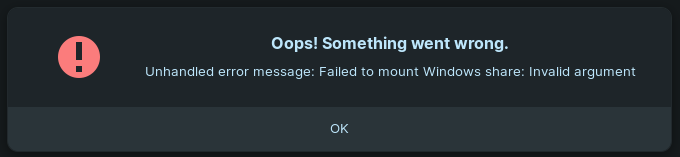

I lost my SMB share as well on my linux machine. The network links are still there but when I click on them I get an error.
I am still knew to Linux. I am using the Zorin distribution of Ubuntu. SMB may not be the best share option but it was working. I have 12.0-U8.1.
opensourceFTW
May 27, 2022
86
I rolled back to 8.0 but the error persists. I just realized that this is an old thread, my apologies.
