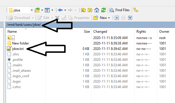

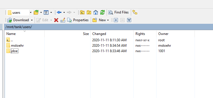

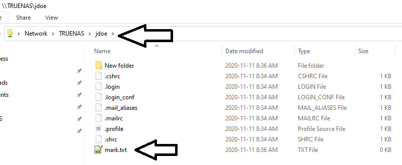

I am trying to setup home shares. TrueNAS creates the correct directories BUT in windows, it adds every user with the same directory files. If I switch logged in user the files change to that user's files BUT also all the other user's directories too.

Windows Explorer showing all users. Here mstoehr is logged in. (currently only 2 users created in TrueNAS)
mstoehr's File folder content with a file called mark.txt
jdoe's file folder showing all the files from the mstoehr folder
The Directories are shown with WinSCP

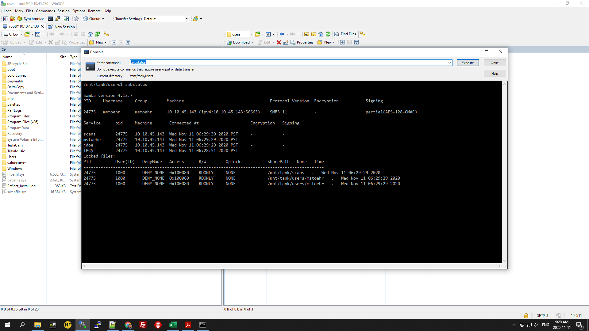

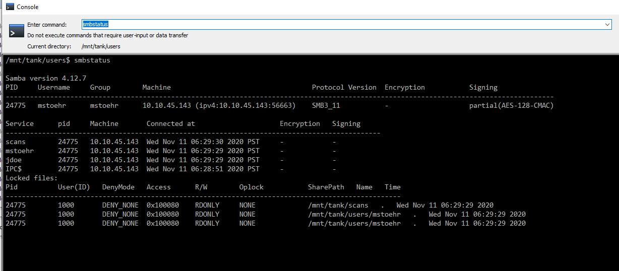

In this case though the path suffix has %U which locks you into the path of the currently authenticated user. You can verify your connect path via "smbstatus".

Thanks for the super-fast response. I am a newbie and need a bit of more help getting it to work. Here is smbstatus when mstoehr is logged in

The way that we generate the share path prevents users from accessing other user's home directories. If you manually try to access someone else's share you will be dumped in your own. In this case, your client should only have seen the mstoehr share. Not sure off the top of my head why you're seeing both users ones. Perhaps we're generating the results of "net share enum" incorrectly :/
