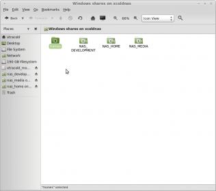

Thanks for the info. I still struggled with the GUI to get things right, or at least understand what was going on. In the end I resorted to the terminal and tidied up all the group ownership and permissions etc, experimented and worked out what was going on. I can now navigate through my CIFS shares correctly.
I have one question that maybe someone can answer though. The 'homes' folder shown below is I think something created automatically by the CIFS service. I cannot navigate to it or find it via the terminal. Does anyone have any idea what it is?
