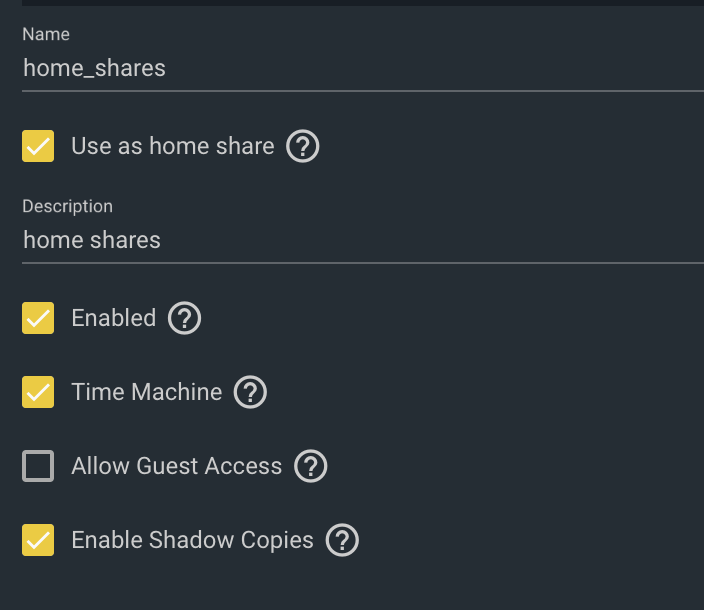

I then setup an SMB share for the home share dataset.
When you do that did you use the "purpose field" and set it to "Private SMB Datasets and Shares" ?
I have not used it myself but I came across another post where this was used erroneously and made unwanted home shares !!

Hm, where are you seeing that purpose field? I have it setup like this for the SMB share settings.
