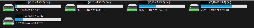

Hello,
I have found several threads here on the forum confirming that this is a expected behavior of a TrueNAS SMB share.
But for my use case it complicates things as seen in the image, one would believe there is at least 40,2 TB left.
The shares come from the same dataset/vdev.
Here are some threads that confirms that this is expected:
In my case I'm going to unmount Media and only keep Private. But to know the true size of what's left I must go into the TrueNAS web interface, which I don't want my users to have to do.
How can I modify this behavior with a patch or setting to make the total reported size (and used) be the size of the actual full vdev/dataset?

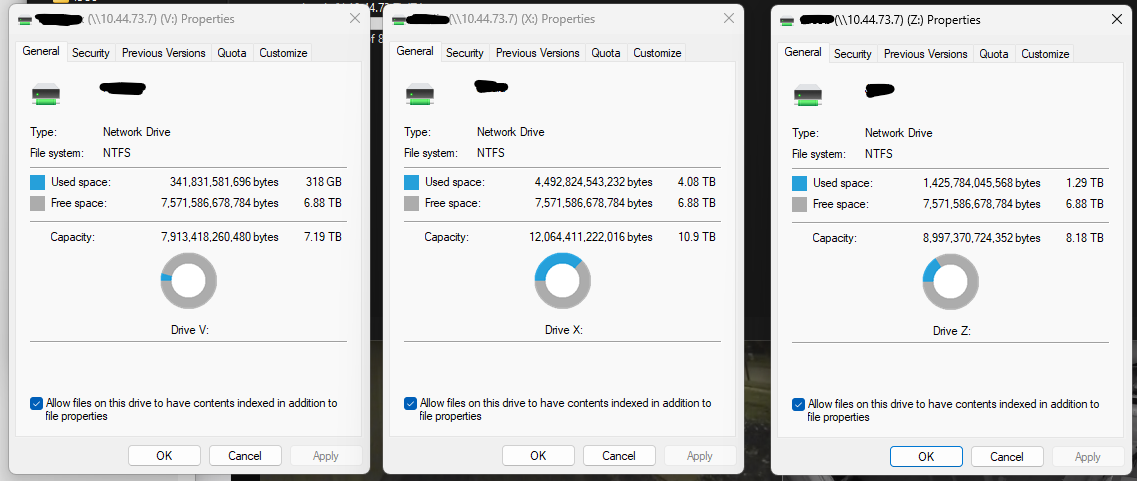

I too am having this issue and have read through as many post as I could find with varying explanations. Once I realized it was an issue I added 3 more shares as mount points and they are all different in the total space number.

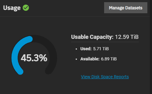

I am running TrueNAS Scale 22.12.0 with a mirrored pool of 2 14TB Exos drives resulting in a total usable capacity of 12.59 TiB. Pictured I have V, W, X, and Z which are different datasets that I have shared from here and Y is an 8TB mirrored pool from my Synology NAS that has it's folder structure the same as the TrueNAS. Because of the way Synology works, it shows the full space usable of the drives and the space remaining (which I want\like). TrueNAS on the other hand seems to only show the space used by the dataset and the remaining space of the pool which results in different numbers from each other.
I understand the math (at least in principle) as to why it does this, but is there a way to have it show the TOTAL pool size minus what's used like on Synology?

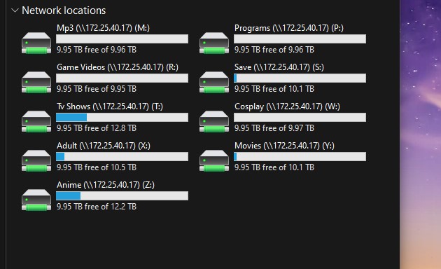

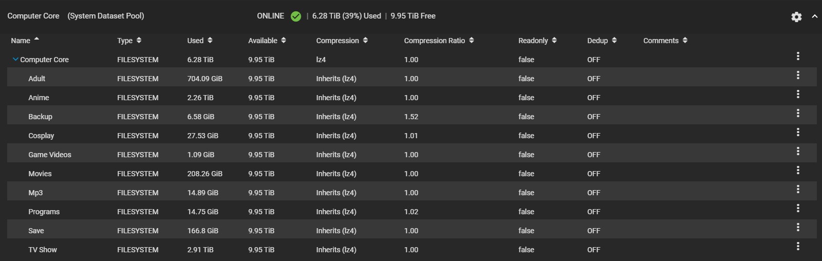

I also have the same thing coming up on mine .. It does look very strange ...

The numbers being reported to File Explorer are correct in that they're identical to what you would see if you typed df -h <path> in the local console. You are basically seeing the ZFS `available` property for the dataset underlying the given path as "Free Space" and the `referenced` property as "Used Space", and File Explorer sums them to show "capacity". It's a GUI issue in windows, but has zero functional impact. If you want detailed and accurate space accounting on ZFS you will need to use ZFS-aware tools (or the webui / reporting framework we have).
