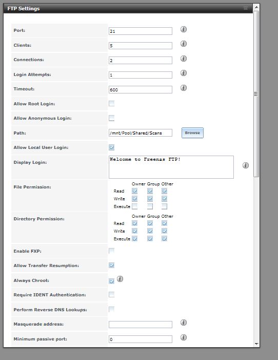

It requires a username / password so i am using the one I use for me (richtj99). The SMB scan failed. I figured I had FTP as a backup & went to Freenas services to set it up. I set the path, added local users (so RichTJ99 would work).

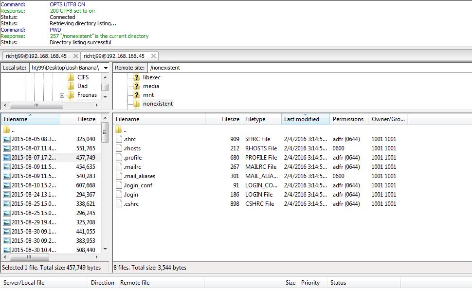

I fired up Filezilla & didnt end up in the scans directory as expected. I am floating around the box but not in the right directory.

My experience is that printers have some of the buggiest / non-standard CIFS clients around. They do just plain weird stuff. I'd start with trying to get it working with the following setup:
1) Select guest user for CIFS (makes sure you do NOT check the box 'disable password login' under Account -> Users)
2) Make dataset for scans that owned by guest user
3) check the boxes "allow guest access" and "only allow guest access"
Once you get it working, try tightening up permissions and seeing where it fails. When in doubt, increase logging verbosity and grab a cup of coffee.

I will give that a try. I am also OK with FTP but again wasnt sure why that failed either.
RichTJ99
Sep 12, 2013
384
And due to an error on my part, its working - MUST GET PATH CORRECT!!! Duh.
