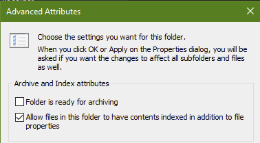

// EDIT: Issue is fixed in NAS-119564 , wait for next release.
The error happens when "Allow files in this folder to have contents indexed" is UNchecked under Properties -> Advanced.
Note that VirtualBox un-checks this automtically for VM default path/directory.

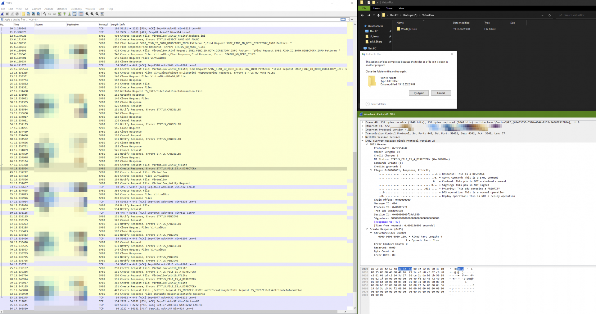

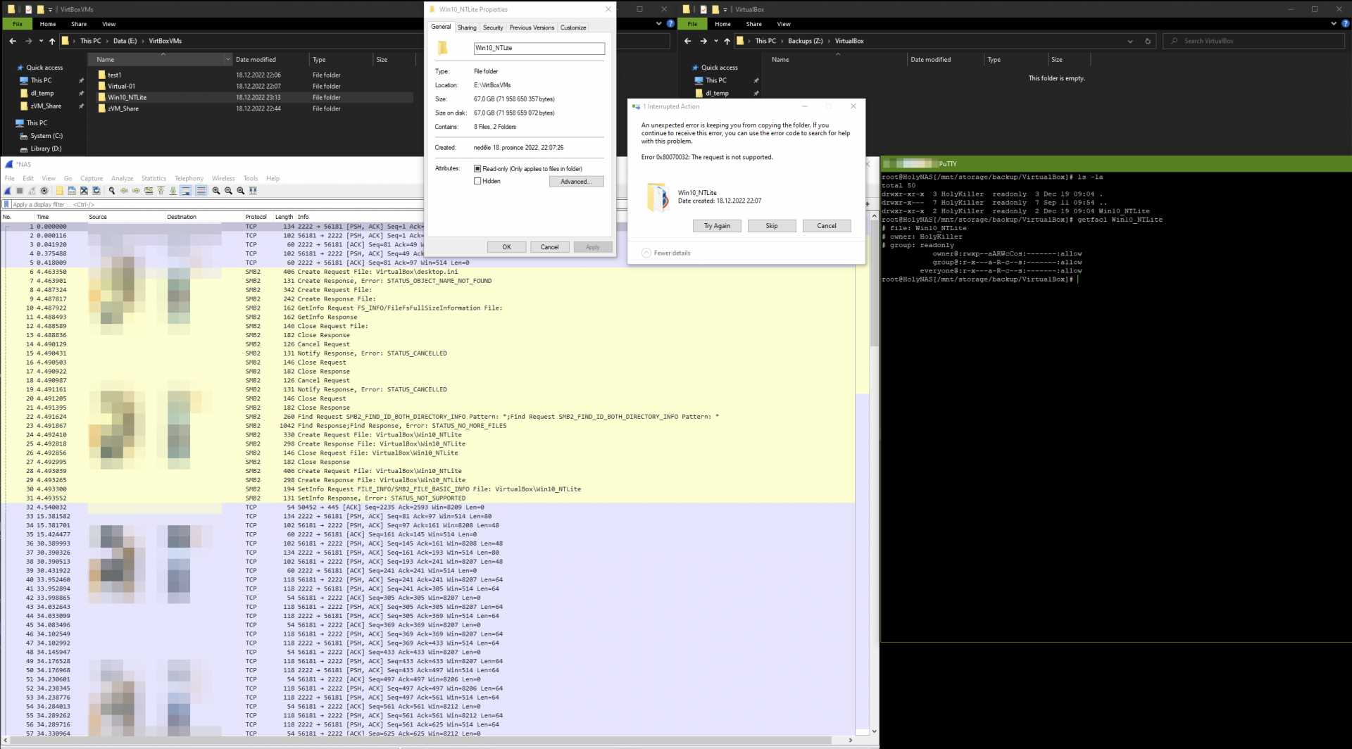

Issue description:
When I try to copy dirs with larger size (big files inside, like 70GB VM file) it fails with this weird error code 0x80070032. If I hit "Retry" the content gets copied but it seems fishy because if I try to delete the same directory it fails with with "Folder in Use". Checking network traffic i see "Error: STATUS_FILE_IS_A_DIRECTORY" for which MS DOCs translates to "The file that was specified as a target is a directory and the caller specified that it could be anything but a directory."
Note that if I try to copy the 70GB file which is inside that directory instead it works just fine.

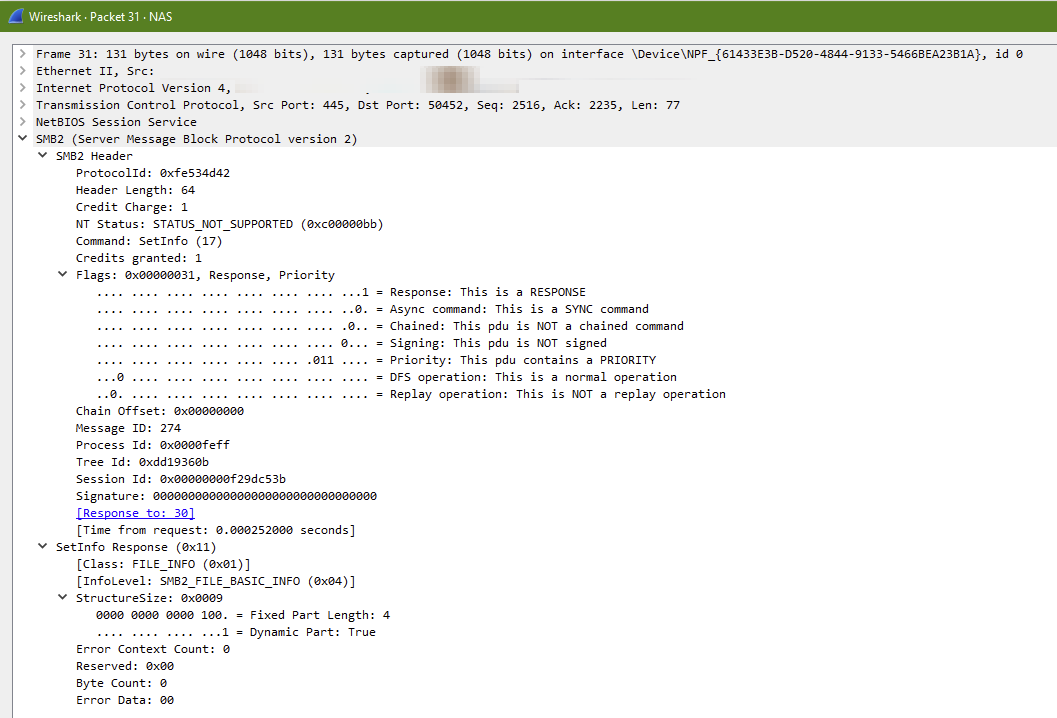

Issue description:
