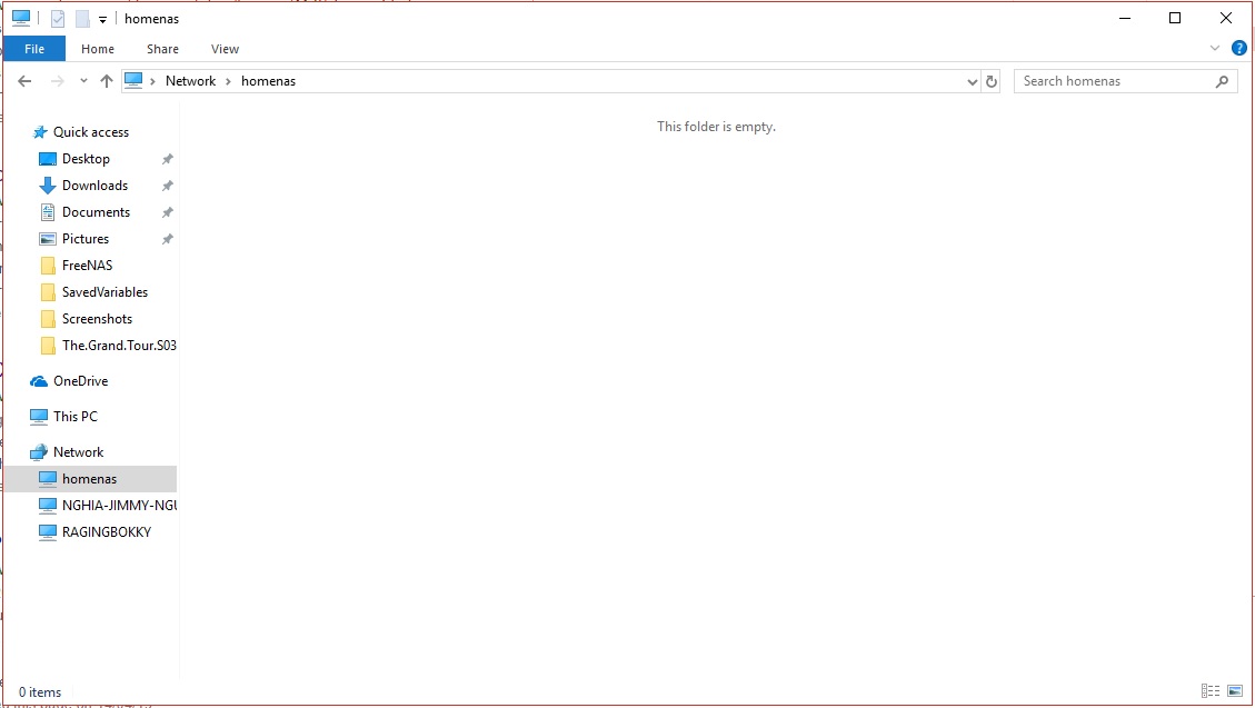

The current error I get when I open the shares

RagingBokky
Sep 2, 2016
9
is there anything out of the ordinary or could it be possible something related to mdns or dns itself?
RagingBokky
Sep 2, 2016
9
For the time being I am usng 11.2-U1 as SMB to be working perfectly on that which also shows that error. I'll probably at some point spin up a VM environment and play with 11.2-U3 and see if I can get it to work there with windows 10 1803 build
