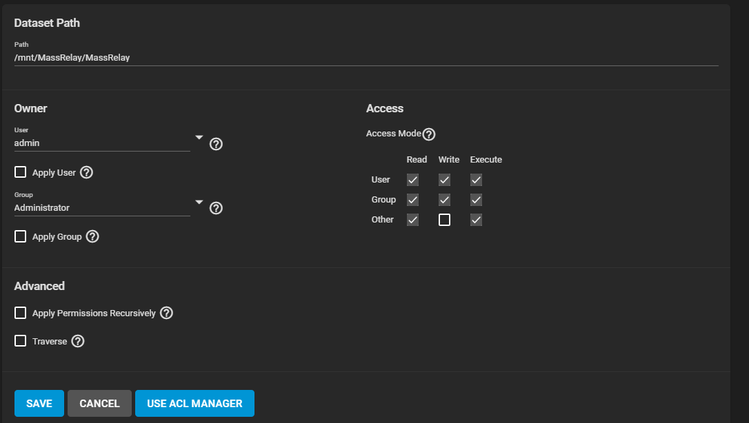

I have a dataset within that pool.
Here's the user named admin within a group Administrator that has access to the smb share and has an aux group of ftp

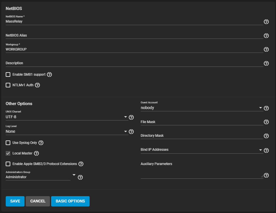

Here's my settings for the SMB share
