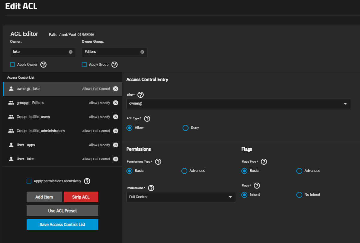

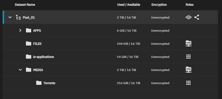

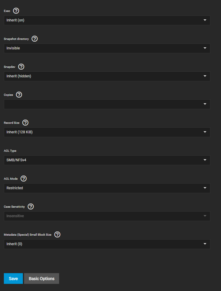

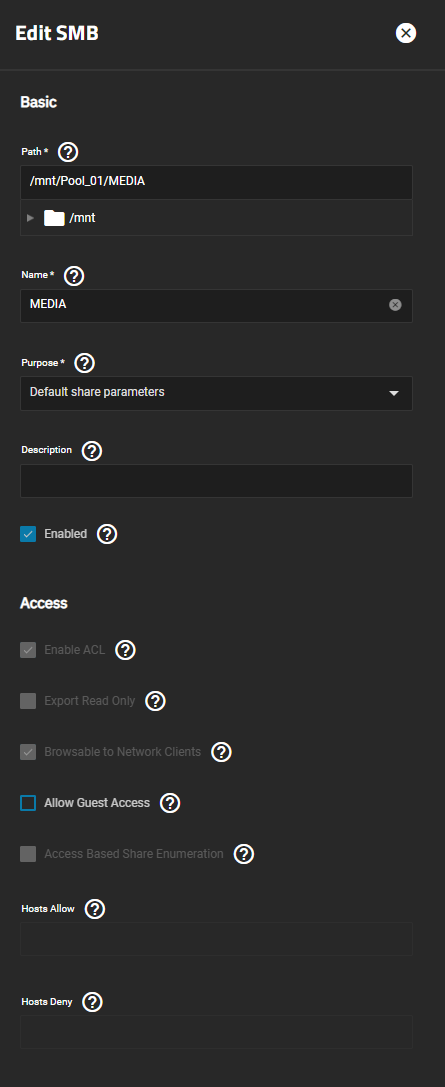

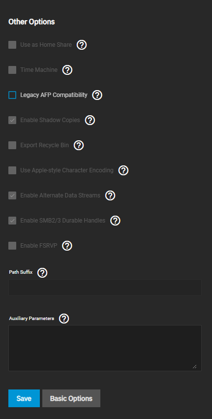

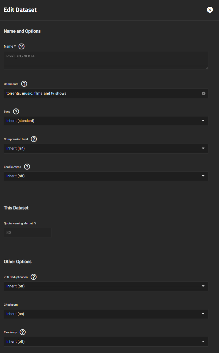

I am new to Truenas and I have been trying to give my Oppo media player access to my SMB share and I just can't get it to work.
I have created a user and in permissions given it access to the share. I can use this user from my windows machines and my android phone no problem, however when I use these details on the Oppo I get: Login Failed please verify username and password.
Attached are screenshots of the dataset and settings, SMB share settings and ACL settings.
Any and all help is greatly appreciated. Apologies if I have not provided enough information (and my lack of knowledge in Truenas).
Cheers.

Check output of midclt call smb.status AUTH_LOG | jq. This may give some indication about why it's failing. This may be one of those devices out there that is using legacy / insecure access methods.
