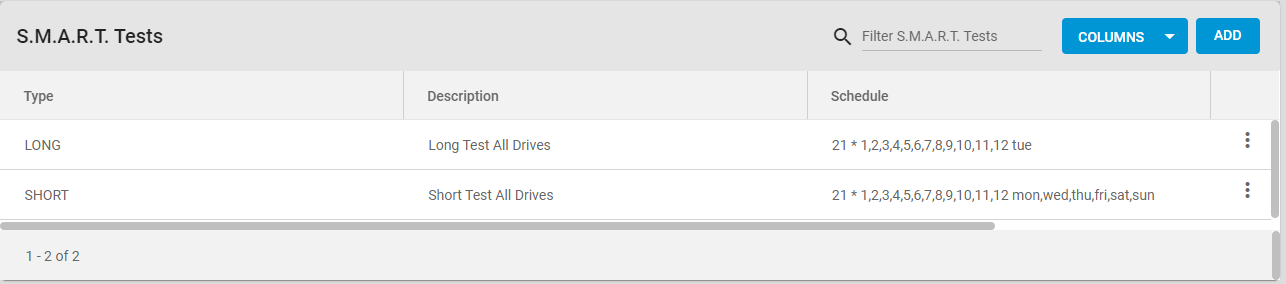

What day do you have the Long SMART tests scheduled to run? The day after is when you should check it to see if it runs. Also, since you didn't post a screen capture of your settings (what you want and actually configure can easily be wrong, been there myself), just so you know you cannot run a SMART Test when one is already running. For example, if you start a SMART Short test at 00:00 every day and then schedule a SMART Long for 00:00 or 00:01 on any specific day, the long test will not run. I'd say 99% of SMART Short tests are completed within 2 minutes, unless they run into read failure. I like to run a SMART Short test at a given time every day of the week and then a SMART Long test no sooner than 5 minutes later once a week.

Also, take a screen shot of the entire SMART Tests screen (see my example below) and provide it to us. In reality you should only have a Long and Short unless you wanted to stagger the drives because you are running a heavy use data center, but that is my opinion and you know what they say about opinions.
Providing this data will give us the needed information we need to give you the advice you seek. I'm fairly certain given both of these we can identify the issue.
