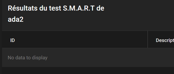

Hello
I use TrueNAS-12.0-RELEASE and when I try to check SMART of disks, I have no results. 22-10-2020_07-49-07-TrueNAS - truenas.poncot.eu.png

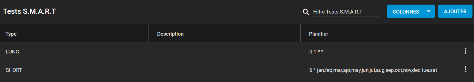

Tested with manual and automatic tests 22-10-2020_07-50-00-TrueNAS - truenas.poncot.eu.png

I have the same problem with a freshly installed TrueNAS-12.0-RELEASE on a freshly purchased TRUENAS-MINI-3.0-X+.
The S.M.A.R.T-service is running and I can start a SMART test with the GUI.
But when I try to view the S.M.A.R.T test results in the GUI it just shows "No data to display".
When I check on the commandline/shell with i.e. smartctl -l selftest /dev/ada0 the successfull self-tests ("Short offline") are shown.

This bug is now fixed as of TrueNAS-12.0-U2
If you haven't already, update your system.
