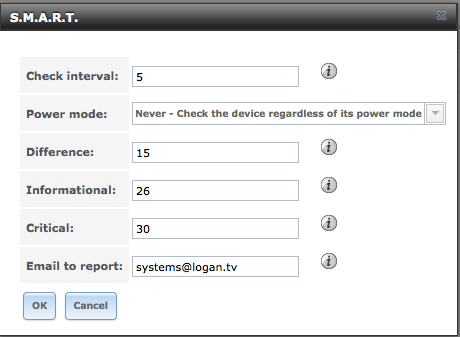

My Service Setting is as follows;
This should run on the schedule I have set under System settings?
* I'm assuming that the Check interval is between individual disks as I have 50. I didn't leave it at 30 to avoid a really long test period. Plus I've read that SMART checks data stored as drive attributes so no load will be incurred.
