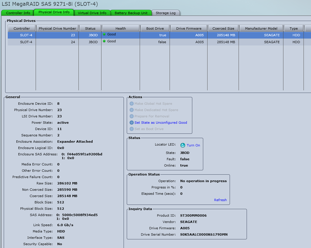

I'm wondering if the "error" we see isn't really an error but a "notification". I noticed when I added -d removable to my entry in the smartd.conf file (see here), I didn't get the config file is empty "error" but smartd still didn't start. I'm just not sure where else to look to see if smartd is failing because of something else.
Dec 29, 2014
1,135
I have noticed something here. It appears that on the main disk controller in my system (Cisco UCS C240 M3S) which is an LSI 9271-8i, the output of camcontrol for disks that are marked as JBOD are not found. Version is FreeNAS-11.1-U5.
I have another system that has an HP D2700 external enclosure with 25 drive in it attached to an LSI 9207-8e. Smart starts on that system, but the script parsing the device list only finds the devices attached via the 9207. The other system has a slightly slower CPU and 64GB RAM instead of 128GB, but is the same otherwise. Same cards, same FreeNAS version. I am going to post the dmesg info and pciconf info in separate messages. Running into message length limits.

Note that it doesn't pick up the drives attached to the 9271-8i here either (da50 and da51). See attached picture from the 9271 showing those two devices attached and configured as JBOD.
