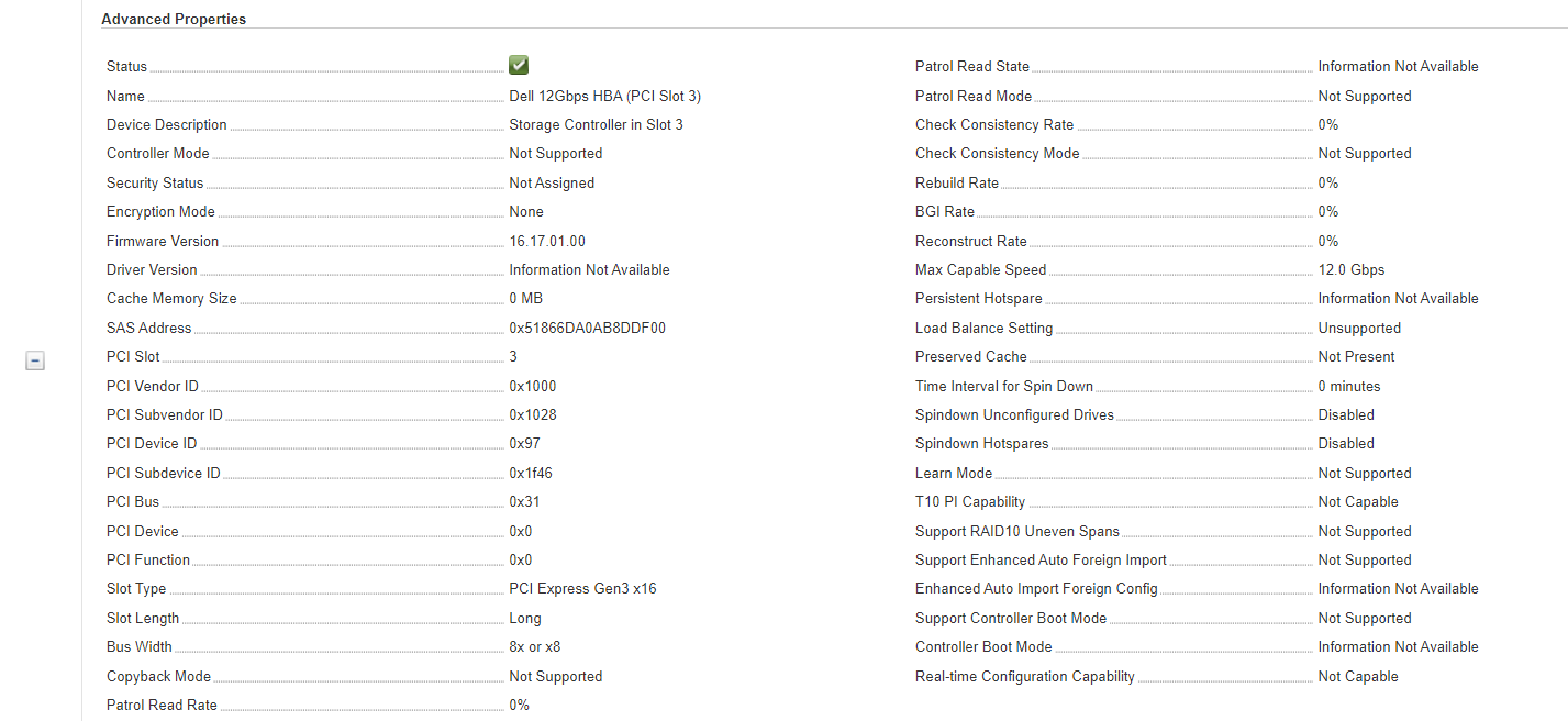

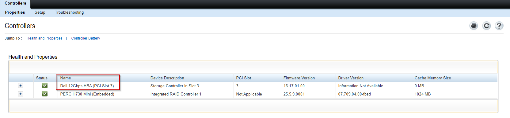

One more thing, we used to have a MD1220 enclosure connected to this machine and I realized that we connected it with 2 SAS-cables, when I look in the iDRAC under Storage -> Controllers I see this:
I am hoping this is the kind of HBA that I need but I am unable to see any information about it. Expanding it just show this and no partnumber:
It would be convenient if all I had to do was swap the cables from the PERC H730 to the HBA.

You should be able to get the iDRAC flagged disk easily, I'd argue for the one throwing "predictive failure" as well if you can get a Dell utility to show you that (either iDRAC or the PERC H730 array config util)
2) I took at look at ebay and you're right - they are only about $150 so I will go a head and order a HBA330(I guess this one is fine? https://www.ebay.com/itm/325121896275?hash=item4bb2c66f53:g:~0sAAOSwM0tiRtHR).
That one will be fine.

Great feedback, ive noted that there are both H330 and HBA330 on ebay. When I look at this specific HBA330 (https://www.ebay.com/itm/224657028779?hash=item344e9a36ab:g:CtMAAOSwg8FiSufM) it says HBA330 in the name and "IT-mode" which is what I think is what I am looking for. Atleast that is what i've found on this forum and checking reddit.
Totally replacing the H730 is no problem for me, I'd run the boot in a mirror, I think that is how our other FreeNAS machines are setup and they have been running fine for many years.
Regarding compression and dedup we always use compression but never dedup, I never tried but I think our machines would handle it.
They all have 128Gb ECC ram and 2x Xeon hexacores, at variating clock-speed.
I have never changed the dataset record size, any guide/link on where and how we change that? We got 4 FreeNAS machines running and I have never before changed this on any of them. Might be worth checking!

Regarding the HBA I'll make the order this week, hopefully its an easy switch and then I'll reinstall this R730xd and cross my fingers.
If it all goes well we will be reinstalling another R730xd that is currently running Nexentastor.
Thanks for all your help and pointers, I really do appreciate it!
