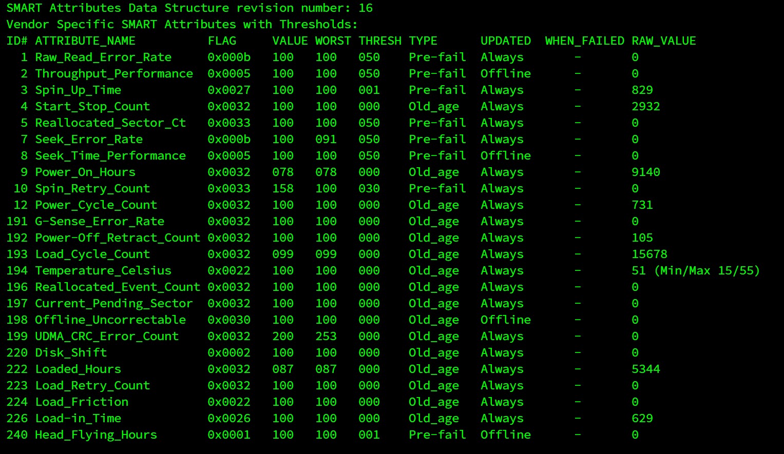

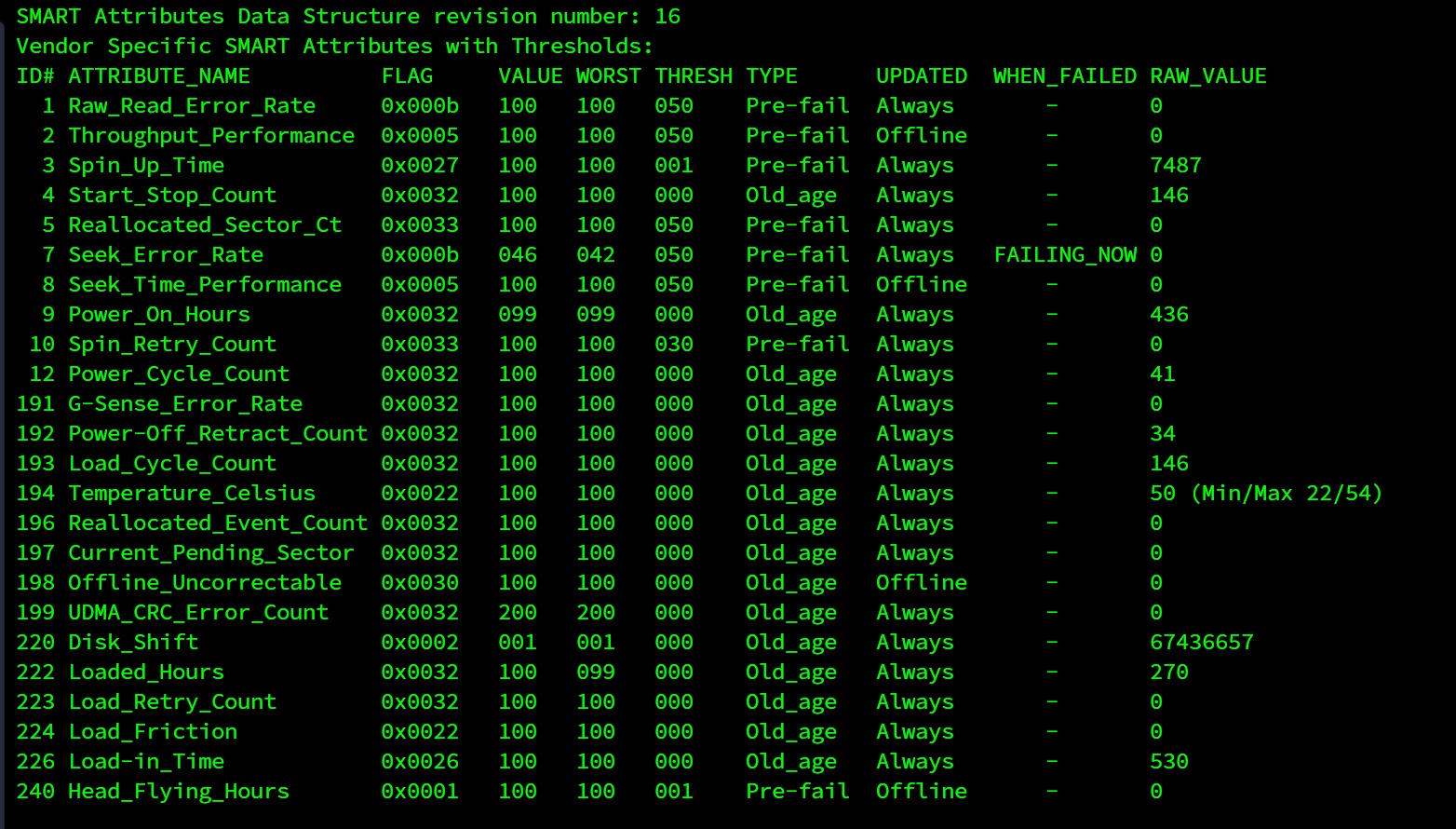

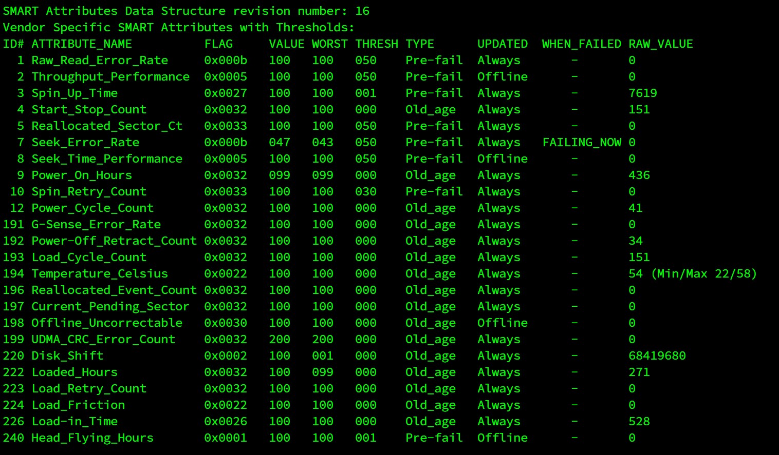

Hey, so I just updated to 12.0-U2 earlier today... and since then, 2 semi-new disks (less than 500 hours each), out of my 3 total disks, have reported a failed SMART.
Attached SMART report for all 3 disks.
They are all Toshiba X300 8TB disks.
The two disks that are reporting an error were bought about a month apart (but both powered on first time at the same time)
Serial Numbers are nowhere near each other, so different batches I'm assuming.
Any advice on this?

It's a common error with those disks, sometimes it goes away after a power cycle, possibly a firmware issue.

wow, that's... mildly annoying.
I got 2 new ones when I built the server, because I've had good results with that third drive i posted a screenshot of../
9140 hours and not a single error.
but both of the new ones have this issue.
unfortunate.
Thank you for response.

Your drives are running very hot, 50C.
Under 40C would prolong their lives.

Yeahhhh I noticed that a yesterday and overnighted some fans. installed them this morning and temps are around 40C now :) appreciate the input!
